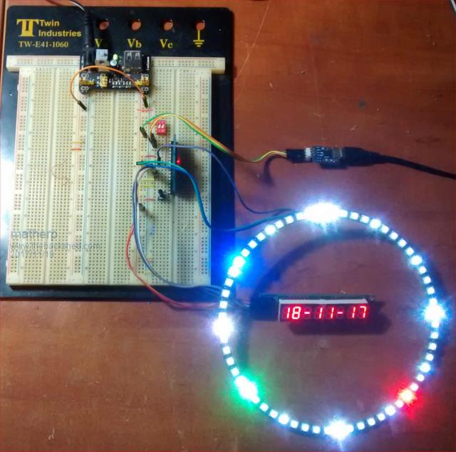

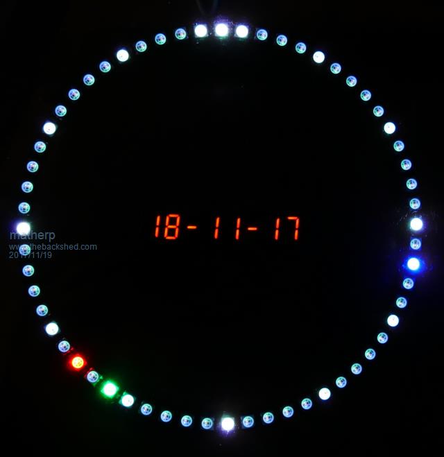

Something completely different
Behind dark smoked perspex 7:17:38
Development environment
This little development uses an ESP8266 programmed with the Arduino IDE.
The ESP8266 connects to my WIFI and downloads the current time and date from an ntp server every 10 minutes. In between the time is updated on the NEOPIXEL ring from the ESP's crystal oscillator. Red is the seconds, blue the minutes and green the hours. The clock automatically compensates for daylight saving. The Date is shown using a MAX7219 7-segment LCD display
Getting the ESP8266 up and running with the Arduino IDE is simple - just google. I then use a standard USB/UASRT to program the ESP. As always with the ESP GPIO0 must be connected to GND to program and then the chip RESET.
The code is attached. It is currently somewhat UK/Europe specific in terms of the summertime calculation but this is easily modified.

previousMillis = currentMillis;
// It's time to do something!
// Use the snapshot to set track time until next event
if(done)epoch++;
DST=epoch;
DST+=(timezone*60);
if(summertimeUK(DST)) DST+=3600;
tm=gmtime((const time_t*)&DST);
for(int i=0;i<NUMPIXELS;i++){
pixels.setPixelColor(i, pixels.Color(1,1,1));
if(!(i % 5))pixels.setPixelColor(i, pixels.Color(10,10,10));
for(int i=0;i<NUMPIXELS;i+=15){
pixels.setPixelColor(i, pixels.Color(70,70,70));
pixels.setPixelColor(59, pixels.Color(30,30,30));
pixels.setPixelColor(1, pixels.Color(30,30,30));
hourpos=(tm->tm_hour % 12) * 5 + (tm->tm_min / 12);
pixels.setPixelColor(tm->tm_sec, pixels.Color(170,0,0));
pixels.setPixelColor(tm->tm_min, pixels.Color(0,0,255));
pixels.setPixelColor(hourpos, pixels.Color(0,170,0));
if(tm->tm_sec==tm->tm_min)pixels.setPixelColor(tm->tm_min, pixels.Color(170,0,255));
if(tm->tm_min==hourpos)pixels.setPixelColor(hourpos, pixels.Color(0,170,255));
if(tm->tm_sec==hourpos)pixels.setPixelColor(hourpos, pixels.Color(170,170,0));
if(tm->tm_sec==tm->tm_min && tm->tm_min==hourpos)pixels.setPixelColor(hourpos, pixels.Color(170,170,255));
pixels.show();
done++;
printdatetime(tm);
delay(900);
} while(done<ntpfrequency*60);
done=0;
// send an NTP request to the time server at the given address
unsigned long sendNTPpacket(IPAddress& address)
Serial.println("sending NTP packet...");
// set all bytes in the buffer to 0
memset(packetBuffer, 0, NTP_PACKET_SIZE);
// Initialize values needed to form NTP request
// (see URL above for details on the packets)
packetBuffer[0] = 0b11100011; // LI, Version, Mode
packetBuffer[1] = 0; // Stratum, or type of clock
packetBuffer[2] = 6; // Polling Interval
packetBuffer[3] = 0xEC; // Peer Clock Precision
// 8 bytes of zero for Root Delay & Root Dispersion
packetBuffer[12] = 49;
packetBuffer[13] = 0x4E;
packetBuffer[14] = 49;
packetBuffer[15] = 52;
// all NTP fields have been given values, now
// you can send a packet requesting a timestamp:
udp.beginPacket(address, 123); //NTP requests are to port 123
udp.write(packetBuffer, NTP_PACKET_SIZE);
udp.endPacket();
Edited by matherp 2017-11-20

That NeoPixel ring is brilliant - never seen them as a 'clock design' before (i.e. with a suitable quantity of LEDs).
I have a 44pin MKI Micromite (MX150) that has been running a 40x8 red led matrix digital GPS clock for over 3years now. My children are just starting to understand how to read analogue time so I wanted to somehow 'retro-fit' an analogue feature to the matrix clock.
So that 'ring' is the perfect addition but I will definitely be doing it as 'cheeseprader' suggests; i.e. for a MM rather than the ESP.
THANKS for sharing this brilliantly simple design idea.
