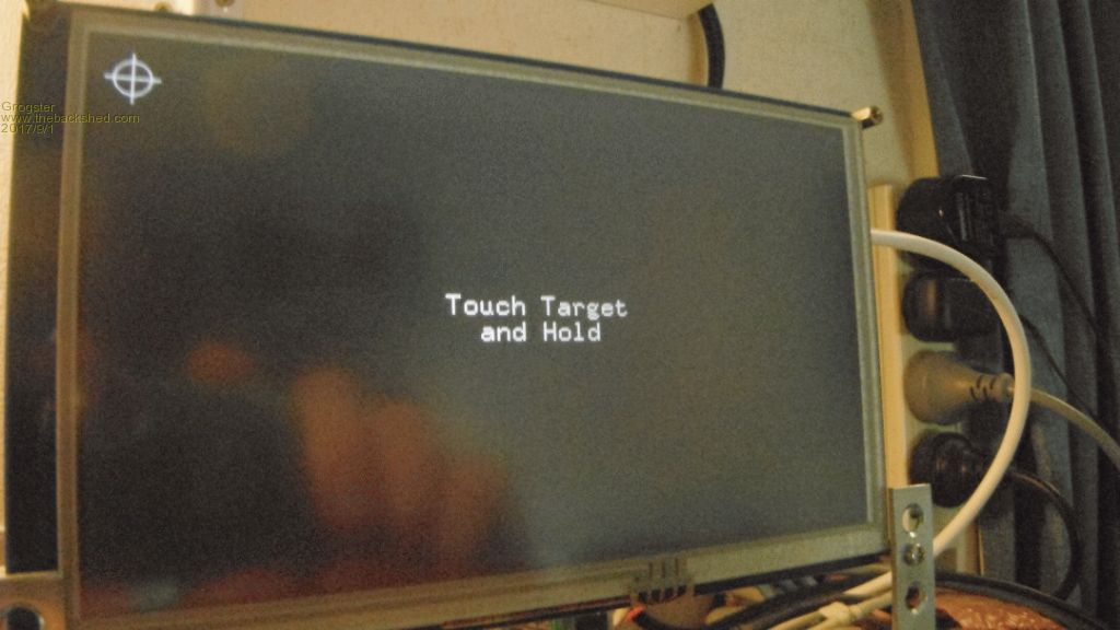

  lew247 said   I thought on the test it drew the touch points
top left top right bottom right bottom left?
It does.
These are normal results. Yours are really badly off.
lew247
Joined: 23/12/2015
Posts: 1709
Posted: 05:52am 01 Sep 2017
The problem was the touchscreen
Luckily I had a spare put away somewhere, found it and connected it and it works great
The buzzer even beeps now when the screen it touched :)
