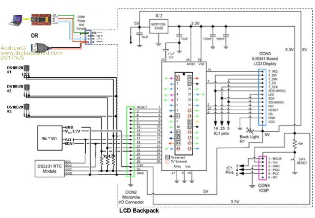

This is the schematic:

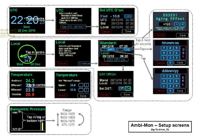

and the set up options look like:
