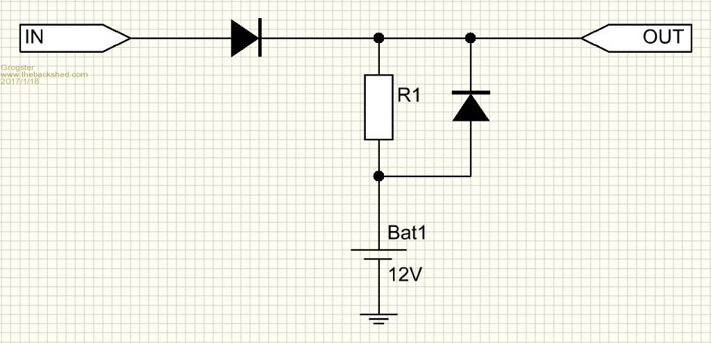

Hi - does anyone have any part numbers for a Gel-Cell charger, or perhaps just a simple circuit?
I need a fully automatic one that switches to battery if the mains fails, and back to charging when the mains returns, all without ever disconnecting the 12v supply to the equipment.
At the moment, I do this with a diode gate and a charging resistor, the latter of which is chosen depending on the charge rate you want and the battery you are using:
This circuit being simplicity itself, in that the resistor sets the charge rate of the battery, and the diode gate blocks the battery going back down to the PSU if the mains fails, and bypasses the charging resistor to supply the circuit in the same situation.
This circuit is for float-charging Gel-Cell's ONLY.
I never use it with NiMH or Li-ION or anything like that!
This works, and I have no problem using it, but I am wondering if there is a better way or more efficient way. Happy to look at charging IC's or other circuits BUT whatever people come up with, it HAS to be fully-automatic like this design is.
A Gel-Cell stand-alone charger is NOT suitable, as the battery remains connected permanently, and must take over if the mains fails, not be taken out to charge it. I'm primarily looking for a design that will stop charging when the battery is full, or can signal the MM or similar controller if it thinks the battery is bad etc.
Open to any suggestions, links, IC part numbers, schematics etc.
I like the current circuit, cos it is so simple and it does work just fine.
You do lose 0.6v across the diode, and that gets worse if you are sucking a large current, but that could be easily enough changed so that MOSFET's were used there instead of diodes.
I have seen this design used in a few different places around the net and they tend to use a 12v lightbulb as the charge current limiter, the benefit of which is that if the battery tries to suck too much current on charge, the bulb lights up and can be used to indicate a charging fault.

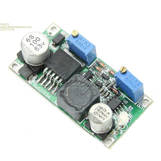

Don't suppose you could use one of these then?
Along with either your existing circuit or a DPDT relay?

@ Phil23 - interesting little module.

Posted: 09:02am 22 Jan 2017
So, for instance (with an ASCII art diagram)?
[code]
e.g., 12V wallwart-o------->|-------o-----Load
| schottky | POWER
.-. 1N5820 3A |
| | ?R - schottky
| | ^ 1N5820 3A
o----------------'
12V Battery (GEL Cell)
0V
[/code]
Battery backup 12V trickle-charged: schottky 1N5820 3A or 1N5817 1A
What value of R is appropriate?
palcal
Joined: 12/10/2011
Posts: 2054
Posted: 11:20am 22 Jan 2017
Depends on the battery I suppose, I would start with about 12 ohms and measure the charging current, then adjust by trial and error.
Paul.
Posts: 10109
Posted: 03:13pm 22 Jan 2017
You really need that extra diode in-line with the wallwart, NOT after the battery as you have your ASCII drawing - see my one at top of this thread.
The purpose of that diode, is to prevent the Gel-Cell battery trying to send juice into the OUTPUT of the wallwart if the mains is disconnected - never a good thing, and depending on the design of the wallwart, could be catastrophic for it's output if the input is disconnected.
Paul is exactly right - it very much depends on the battery you elect to use.
In my case, I aimed for ABOUT a 50mA or so trickle, so I ended up with 18 ohms for my 12v/3Ah Gell-Cell, and that seems to work fine. I just used a 1W carbon resistor, mounted proud of the PCB for cooling. It does not get very hot anyway.

Posted: 12:49pm 26 Jan 2017
Sorry for the transcription error with the diode. So, perhaps
[code]
power pack, e.g.,
18V--DC-DC--->|----o----------------o-----Load
schottky | | POWER
1N5820 3A .-. |
| | 18R 1W - schottky
| | ^ 1N5820 3A
o----------------'
0V
schottky 1N5820 3A or 1N5817 1A or MBR745 7.5A
experiment to determine proper voltage for charging
[/code]
Do you use something like a laptop charger for your power pack? Then perhaps for DC-DC, something like this (3A)? http://www.ebay.com/itm/DC-DC-Step-Down-Power-Supply-Adjustable-Module-With-LCD-Display-Without-Case/272241993041
Would this be a suitable Schottky diode (45V, 7.5A) http://www.jameco.com/Jameco/Products/ProdDS/790954.pdf
And one "proud" 18 ohm 1W resistor (for 12v/3Ah Gel-Cell).

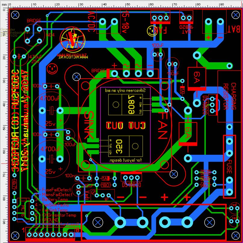

Posts: 10109
Posted: 01:20pm 26 Jan 2017
My raw PSU is a step-down transformer, feeding my own PSU board. That outputs about 14.4v(at the regulator output, before the diode-gate):
The FanSink is a Video-card chip-set cooler, and the main 350 regulator and 7809 for the cooling fan are mounted horizontally underneath, and attach to the FanSink bottom via a hole cut in the middle of the board.
There is a big barrier-strip(screw terminal) output block, and also an 8-way power+sensor output, which can connect to the MM's I use, and they can then monitor the PSU vitals such as FanSink temp, FanSink fan tacho and charging resistor temp etc, and monitor the fuse and mains for failures.
EDIT: I should also mention that there is a insulating gasket under the fansink, the same shape as the fansink footprint, to both isolate the tabs of the regulators, allow heat transfer, and prevent the fansink from touching the top tracks running under it. I used blue 0.5mm thick thermal pads from eBay, and just cut them to match the fansink by running a knife around the edge of the fansink to get the gasket shape.Edited by Grogster 2017-01-27
