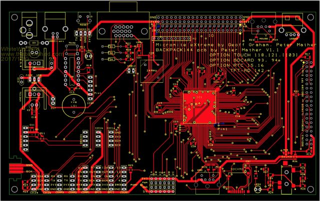

Here is a graphic for the Top layer & Silkscreen,
Working clockwise around the edge of the PCB (from Top Left corner):
- Power input socket
- USB Client (Type B) communication socket (and Power option)
- Reset switch
- VGA output socket
- I/O Connector (Digital/Analogue) + Power connector for external 'stuff'
- PS2 Mouse socket
- USB Host socket (for future use!)
- 40-way TFT connector (SSD1963, S6D0164, ILI9325, SSD1289)
- 3.5mm Stereo jack socket (WAV & tone output - line level)
- HeartBeat LED (think of this as a flashing Power LED - It can be disabled (turned off))
- uSD Card socket
- PS2 Keyboard socket
- PWM connection headers
- COUNT connection headers
- SPI1
- SPI3
- COM 1
- COM 2
- COM 3
- I2C2 (x2 headers)
- Nunchuck edge-connector
- DS3231 Socket
- Power selector jumper (between the two heatsinks/vRegs) to select Power source (Power Jack, or, USB)
Other points to note:
- Towards the upper left corner is the PIC1454/5 USB-to-UART circuit complete with 'Mode' button, and 'Mode LED'
- I2C1 (x2 headers) are to the right of the RTC (and above the two SPI headers)
- On board buzzer (above RTC)
- Heavy duty vRegs complete with mechanical heatsinks
- Console connection (should you need it!) to the left of the VGA socket
- ICSP header to the right of the buzzer / PIC1454/5
Mounting holes are located for direct mounting onto a 7" TFT (tested with SSD)

Wow.. Nice layout...
So, the RTC uses the same module as the E-100 board.. I did order 2 of them... I think I see some tracks going to the other side.. Are you using the memory IC part of the RTC module..?
Thanks Gent's..! This is ant awesome design project

Hi Zonker;
A word of warning regarding the use of E100 'configured' RTCs on the MMX.
On an E100, the RTC 'pins' are effectively facing downwards so that the RTC battery ends up 'sandwiched' between the E100 PCB and the RTC PCB.
On the MMX, the RTC pins are reversed meaning the battery needs to be facing 'upwards' (i.e. not sandwiched between the PCBs).
So both the E100 and MMX 144 can use the same RTC module - but the pins need to be installed either upwards, or downwards, to match the MM PCB accordingly. If not, the RTC memory gets very hot, very quickly!!
Alternatively, leave the pins at right angles (as normally supplied from the Chinese suppliers), then you can plug the RTC into either PCB, however, the RTC will be at right-angles to the MM PCB and hence not very 'low profile'
Hope this all made sense . . . .

Thank you fine Sir..!
I would have not noticed it, and cooked it..
I took the RA pins out of the E-100 RTD module and fitted up the straight ones...
I will be doing the same for the new MMX PCBA... (did we name this one?)
Is the I2C memory IC wired in..? Code to use it..?
Thanks again WW for your feedback on this..!

Zonker: The memory chip on the RTC is addressed/accessed via the same pins as the RTC. I remember there being some code somewhere on TBS to access this memory - but it is something I have not 'played' with personally.
There is an OPTION RTC 15,16 setup command to automatically let MMBASIC talk to the RTC. With this set, I do not know if the memory can then be accessed.
I will communicate with Peter Mather regarding this to clarify . . . . .

@Zonker
Good news about accessing the Memory chip. Here is Peter's response:
  Quote  Option RTC doesn’t affect ordinary use of I2C so Zonker just needs to write some appropriate code to access the memory

Ok.. Thanks Gent's.. Will look into in...
On the E-100 I dint think it was wired in...
I didn't see any tracks going to the smaller connector..

The smaller connector on the RTC module, is just a repeat of some of the connections on the other side of the module, so they are only there for mechanical support of the module, and nothing else. You can use either side, in other words.
