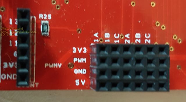

So please note the following SilkScreen/Solder-resist issues:
PWM Header:
This is the important one!
The 3v3 and 5v legends are the wrong way round.
So on this version of the PCB, you can safely plug your 3v3 PWM devices into the 5v output
DO NOT PLUG 3v3 PWM DEVICES INTO THE 3v3 OUTPUT!
Peter has already fixed this for the next revision PCB

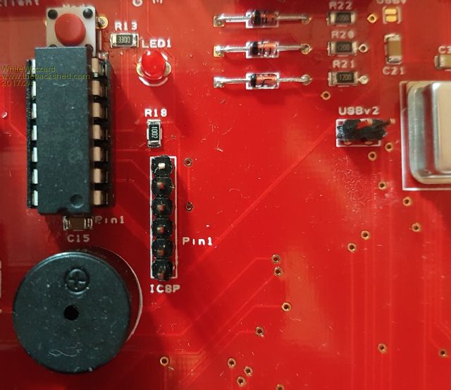

ICSP:
The ICSP Pin 1 is the 'bottom' pin. The Silkscreen legend is slightly higher than it should be

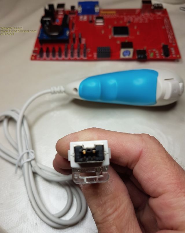

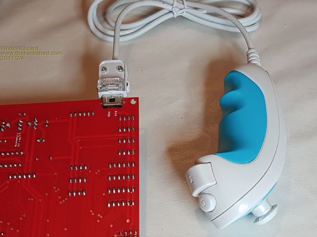

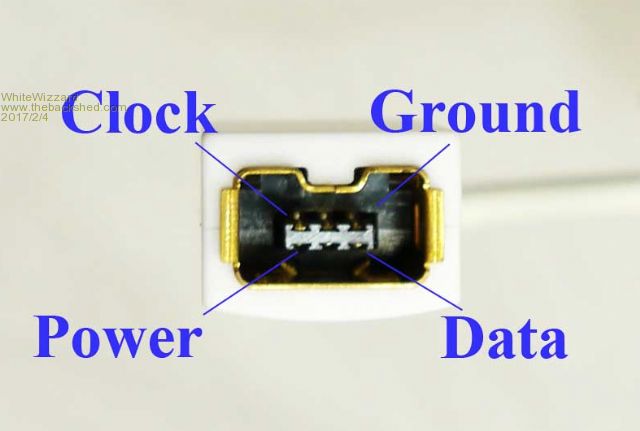

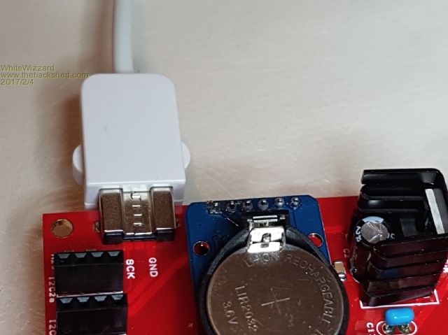

NunChuck Connector
A NunChuck can be directly inserted into the MMX144 PCB to allow software control of the mouse pointer (and many other menu driven type functionality - as well as a 3-axis accelerometer). However, the NunChuck could be inserted either way around - so beware as you have a 50% chance of getting it wrong and possibly damaging the NunChuck itself!
In most commercial products that utilise a NunChuck, the product's case provides a key-cut-out to ensure correct orientation of the NunChuck. However, the MMX PCB is not cased (yet!). So please refer to the following photos to help ensure correct usage:

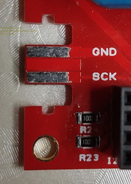

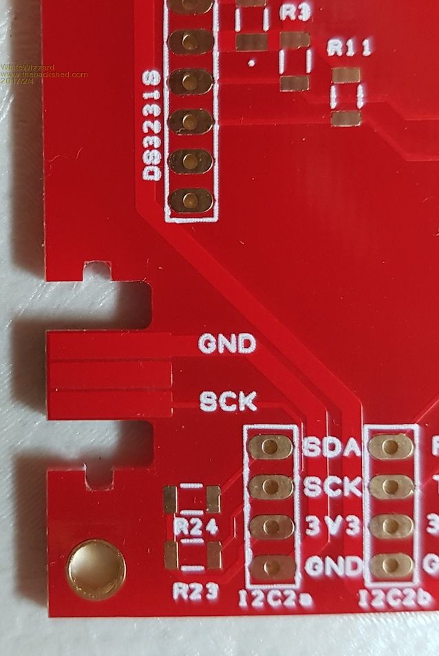

The NunChuck connector has the solder resist still over the four required connections (two top, two bottom):
I simply scraped the solder-resist away (using a knife blade) on the four 'outer' pads; and then run a bed of solder over the exposed gold contact:
For those of you with really sharp eyes, I also had to increase the gaps on this connector by filing about 0.5mm off both top and bottom edges (i.e. the ones with the 'notch cut-outs')
NunChuck Pin-out (that matches PCB silkscreen legends):
And in real life:
NOTE: On Genuine NunChuck's, and on 'most' clones, there is a big 'lump of plastic' This can also aide orientation in addition to the 'U-shape' key on the metal part:

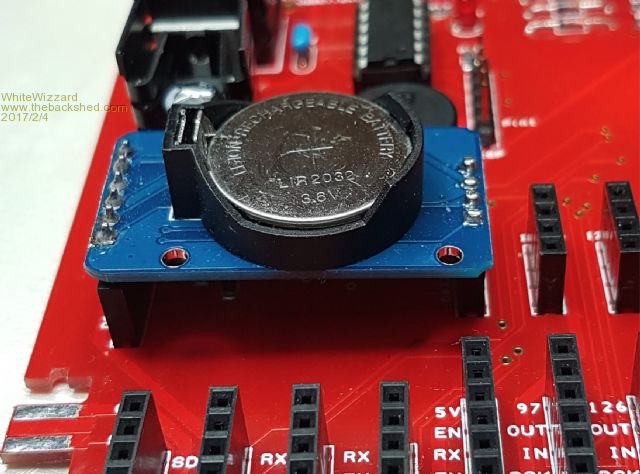

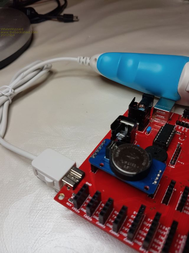

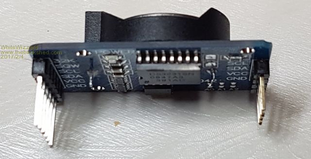

RTC:
The orientation of the RTC is the opposite to those of you that are using the Explore 100 - so beware!
I like to add pins to the RTC; so for the MMX144 they need to be like this:
And when mounted:
Thats all for now folks. Hope the above is clear enough to follow.

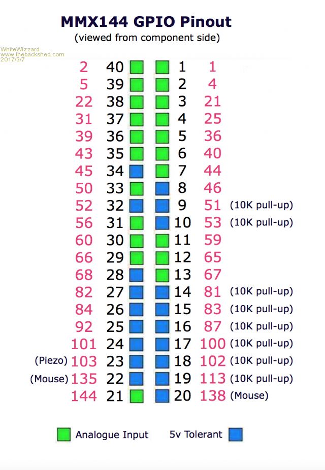

Posts: 2998
Posted: 11:58pm 06 Mar 2017
Especially for Panky . . . .
Peter will add to next version of MMX manual (he has probably done so already!)
Posted: 12:58am 07 Mar 2017
are those "has 10K pullup" or "requires 10K pullup" (i.e. open drain) ?
Posts: 2998
Posted: 01:13am 07 Mar 2017
  CaptainBoing said   are those "has 10K pullup" or "requires 10K pullup" (i.e. open drain) ?
There is provision for a 10K SIL Resistor package (R2) to be mounted on the MMX (close the the GPIO connector). I have installed it on all the MMX144 modules so therefore the meaning is 'has a 10K pull-up'.
I will let Peter confirm if they are open collector or not as I don't want to mislead anyone.
(I believe all pins shown in blue are Open Collector as they are 5v tolerant on a 3v3 operated PIC - no doubt someone will clarify shortly!)
