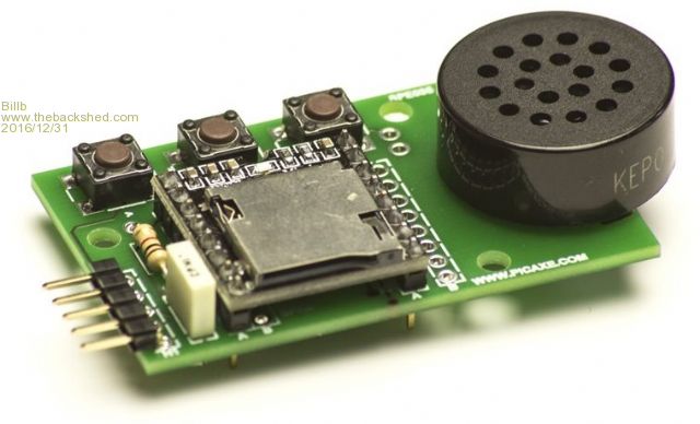

Hi Grogster
I have used the PICAXE SPE035 module in my robots with great success.
They are available for the Picaxe store for about UK 9.00
This is a video using a 170 to trigger the module.
https://www.youtube.com/watch?v=BNP2ViHBlGo
Sample code I used to test the messages for the robot
[code]
option autorun on
OPEN "COM1:9600,S2" as #1
Setpin 17,Din
Dim integer CMAD,arg,arglsb,argmsb ,a
pause 30
CMAD = &H09 'initalise SD Card
arg = &H0002
senddata ' Set Volume
CMAD = &H06
arg = 40
senddata
do
for a = 1 to 36
CMAD = &H12 : arg = a 'Select track
senddata
Do 'Wait to track completed
Pause 100
Loop until pin(17) = 1
pause 1000
next a
pause 1000
loop
sub senddata
argmsb = 0
arglsb = arg
pause 100
Print #1, chr$(&H7E) chr$(&HFF) chr$(&H06) chr$(CMAD) chr$(&H00) chr$(argmsb) chr$(arglsb) chr$(&HEF);
pause 100
end sub
[/code]
