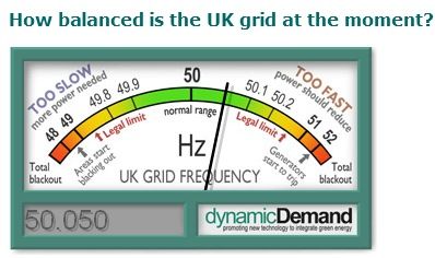

[URL=http://www.dynamicdemand.co.uk/grid.htm]
Had another look, and yes it does appear genuine. That is the sort of display I would likeEdited by Herry 2017-10-16

Posted: 06:31pm 14 Oct 2017
  CaptainB said
  HankR said
I would like to be more accurate (I believe by law the mains frequency may not be beyond 1% of spec).
That was me, but only quoting Herry.
  CaptainB said  In the UK I think you are right although without researching it I don't know what it is.
If you look at the almost real time UK grid load meter, you'll see the legal limit departure from 50 Hz marked for what looks like 1% over and 1% under.

Posted: 08:02pm 14 Oct 2017
DSO is a Hantek DSO 5102P. Haven't done much with it yet. It cost over A$500. Re the meter above. The scale is not linear so difficult to estimate the 'legal' points... But yes, it does appear to be real real time after all!
