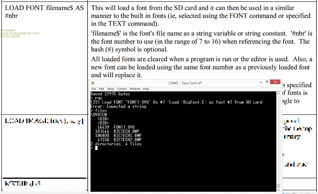

Trying to use the LOAD FONT command on an E100 board, but I keep getting an odd error:
Expected a string?
I also tried DIM'ing F$ and making F$="FONT7.SYS", and putting that in the command, but get the same result back - expected a string. What gives?
When this error comes up, it also wipes out F$. So, F$="" and confirmed with ? LEN(F$), which returns zero.
F$="FONT7.SYS" prior to the LOAD FONT command, so the LOAD FONT command itself is wiping F$ as part of whatever it is doing.
Can anyone else please test the LOAD FONT command to see if they are getting the same issues?

From the changelog
For V5.2
Removed the LOAD FONT command (DEFINEFONT achieves the same outcome).

I have copied the BigFont.BAS C-code thing into the bottom of the code and used DEFINEFONT #7, and it is working fine.
I still have plenty of space on the MM+, so I will just leave it there along with the only other C-function as ASCII, but if I get squeezed for space, I will move both to the library.
