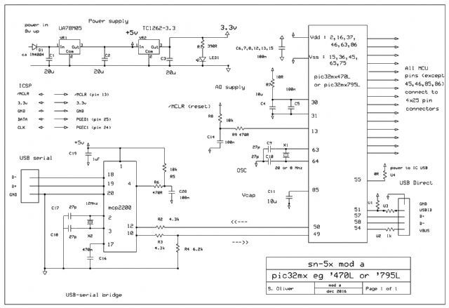

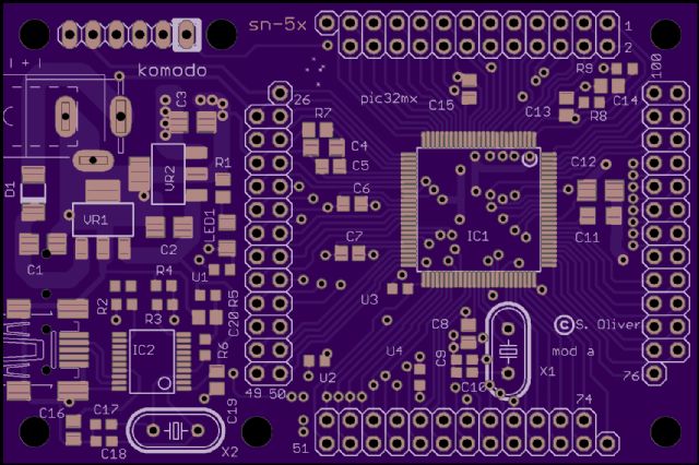

This is a small pcb for 100 pin /14mm pic32mx, it should be ok
for pic24 and dsPic also. It might be described as a self-powered
mcu board with pin connectors and usb and serial-usb ports. Practically all the mcu pins are brought out to the connectors. The regulator gets a little hot at 12 v but is ok for moderate currents. The power supply is under-designed, I had some surplus 20uF tantalum caps so I used those, most components are not critical.
It is tested and works OK.
It was originally intended only as an exercise but turned out to be too useful in its own right. This is mod a which is almost certainly the final version as I have moved on to the MZ version sn-7x. Others have requested it, I promised schematics etc so here it is.
Please refer to it as "sn-5x", any errors please tell me !
schematic :

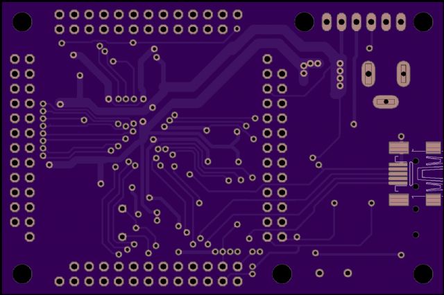

the pcb :
and components :

I should add, the serial comms use pins 49 and 50, but there is
provision for rerouting, ie flying leads can connect the bridge to any other two pins, and the connections to 49 and 50 have a cut zone and so can be severed cleanly if needed - it is a fairly generic board.
As a hardware test I loaded the explore100 micromite software on it and the chevron prompt popped up OK on the USB console. If a serial connection via 87/89 is needed it may be ok to simply connect 49/50 to 87/89 as well, I am not sure how MM/explore100 uses 49 and 50. Pin 49 is described as usbid, 50 a 1Hz clock, so they are probably read inputs, is that right ?
