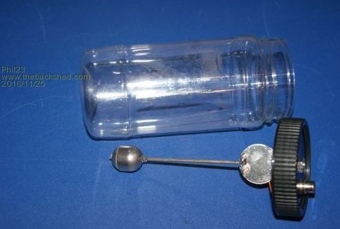

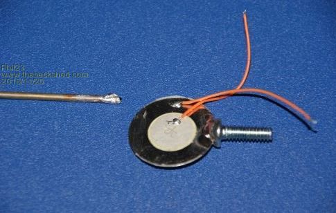

Food for thought regarding an easily built sensor...
Pretty self explanatory.
Phil.

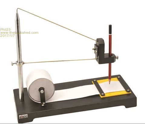

Still got this idea ticking away in the back of my mind.
Any thoughts on adding a sensor to this?
$116AUD.
Here and here.
