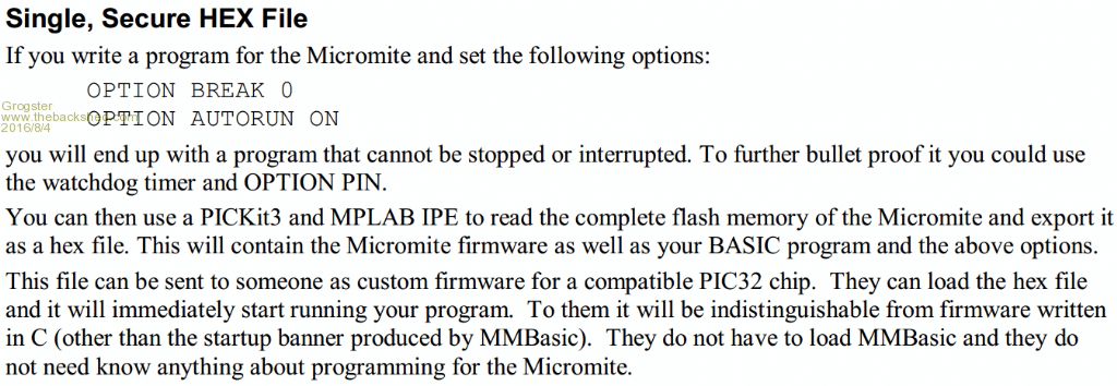

Using PK3 and IPE, READ the chip instead of writing to it.
This will read the entire memory into a new HEX file, which you name and save somewhere.
If you reflash THAT file back into your MM chip, it will be pre-configured to talk to the RTC, LCD etc, etc, etc......
Naturally, that only works if you KNOW the situation it is going to be used in, otherwise it may cause something buggy to happen - like if it tries to talk to an LCD, and there is not one there - that kind of thing.
See the manual, page 16:
  Phil23 said  I can read from IPE, but not sure about creating the Hex file from there. Only option I see that's relevant is File | Export.
Does that create a valid Hex file that would be a complete backup of what's currently in a chip?
YES.
