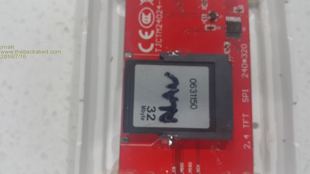

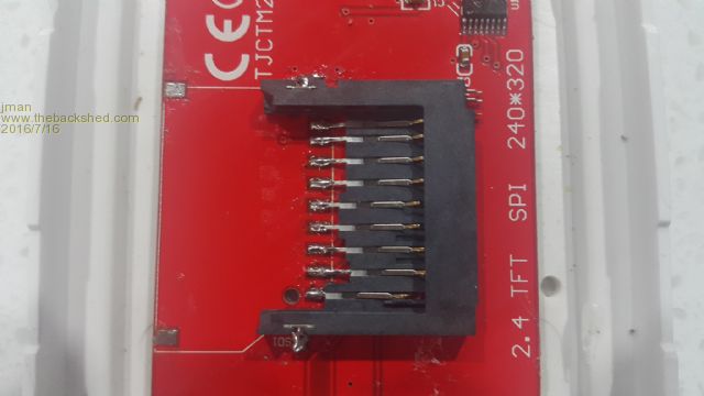

I changed the SD Card holder on the back of the LCD to allow me to plug
a SD card in that did not stick out the side as this did not allow mounting
in the wall plate.

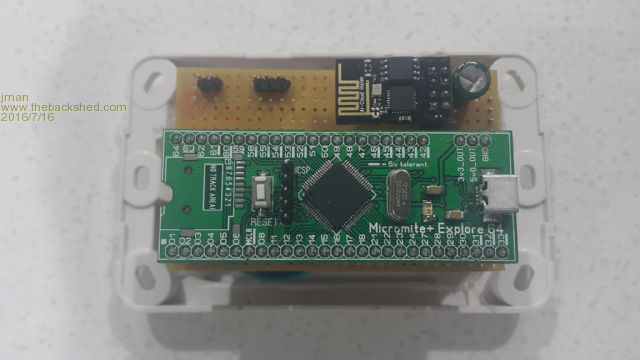

Internals

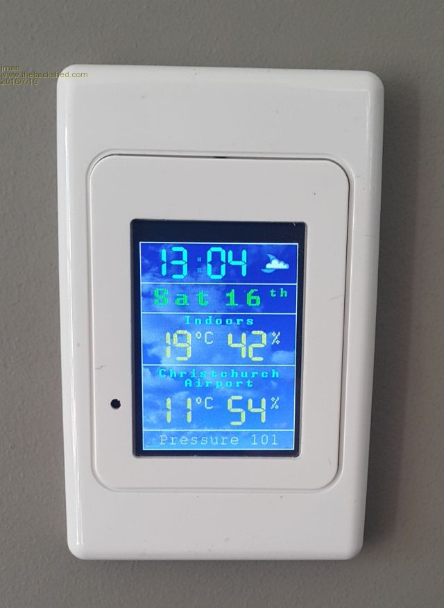

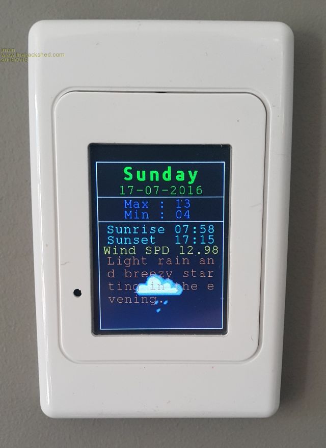

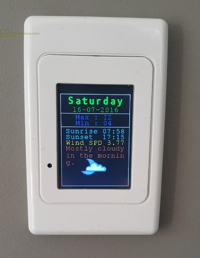

A few pics of the unit working
2016-07-16_021648_WeatherDisplay.zip

Wow Jman..!! I had no idea that all that could fit int a wall box..!
Nice looking, well planned out display graphics and sections..!!

Please can you provide a link to that SDcard slot. That is a GREAT mod
jman
Joined: 12/06/2011
Posts: 711
Posted: 12:30am 16 Jul 2016
  matherp said   Jman
Hi Sure
First link allows single item purchase second link minimum purchase
quantity is 5
Link 1
Link 2
Jman
