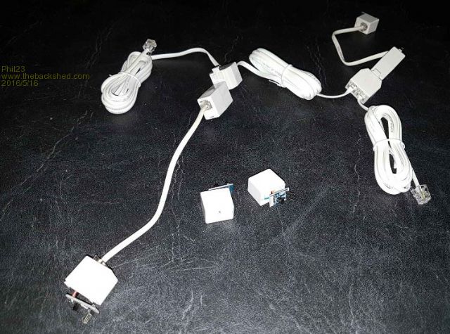

I've said a lot about multiple DS18B20's on a single bus.
Here's how I intend to physically cable them.
RJ-11 6P4C jointers easily pull in half, you can then cut the wires in half & join them to 2 devices.
Using more joiners & M-FF double adaptors it is simple to install a bus with droppers.
My total bus length will be about 30m, with about 8 droppers each about 2m.
This seems well under some of the examples that are mentioned in these guidlines.
How reliable it performs long term as far as connection reliability, I'll have to see.
I do know my weather station contains 4 RJ-11 connections & has been exposed to the environment for over 5 years with no issues.

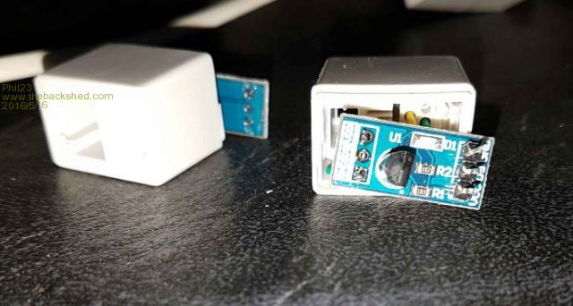

Question I do have is; the modules each have their own 10k terminator. 8 on a bus is going to be well below the 4.7k recommended in the MM manual.
Am I best to remove the resistors from each module?
Also each module has a power LED; best to dispense with that as well?

akashh
Joined: 19/01/2014
Location: India
Posts: 115
Posted: 05:32am 17 May 2016
A client of mine used about 15 of these, not sure if they were in a star arrangement or daisy chained, but he used a single pull up resistor at the mcu side, it was between 2.7 and 5.1k, you may need to play a bit to get it right, but there were no terminating resistors anywhere else.
The exact sensors he used were the Chinese waterproof ones, with no LED or pull up. I would remove those if possible.
AkashEdited by akashh 2016-05-18
Phil23
Joined: 27/03/2016
Posts: 1667
Posted: 11:26am 18 May 2016
  akashh said   A client of mine used about 15 of these, not sure if they were in a star arrangement or daisy chained, but he used a single pull up resistor at the mcu side, it was between 2.7 and 5.1k, you may need to play a bit to get it right, but there were no terminating resistors anywhere else.
Akash
That was my thoughts, remove the 10k's.
8 of them would be giving me a pull up value of 1.2k at the processor. Pretty low.
What about the LEDS? Any likely significance from the current they draw on the power line?
Also using the waterproof ones where applicable.
Phil.Edited by Phil23 2016-05-19
Posted: 07:01pm 18 May 2016
A single LED will probably use between 10-20ma.
Depending on your power source this could be huge or small. :)
