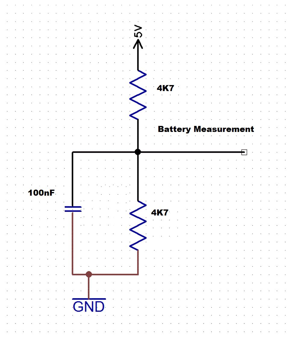

Is the circuit below sufficient to measure voltage on a micromite?
The battery I want to measure is a 5V battery.
I'm as assuming (hoping) the ADC will be measuring 0-2.5V?
Will the resistors drain the battery? ie if I expect the battery to last for a very long time without the circuit will it take much from the battery?

  Quote  Will the resistors drain the battery?
Yes, power consumed is (V*V)/R so in your example roughly 2.6mA
There is an easy way round this: Connect the bottom of the divider to another Micromite pin that is set as an input and then just set it to a low output when you want to take the measurement leaving a few milliseconds for the capacitor to charge before taking the reading. Once you have the reading set the MM pin back to an input.

  Quote  Yes, power consumed is (V*V)/R so in your example roughly 2.6mA
Sorry should read "2.6mW" or 0.52mA

Hi Lew,
I don't think you need the Capacitor at all..
Just the 2 resistors is fine.. You can always increase the values to minimise current drain..
