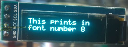

This font looks really nice on the small display (96x16)
Thanks for this.
These OLED displays have having an amazingly clear image
the photos do not do them justice
Jman
