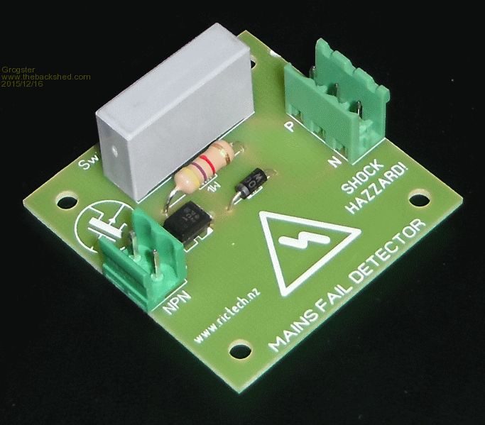

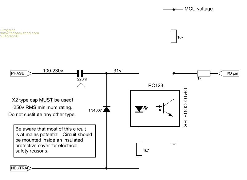

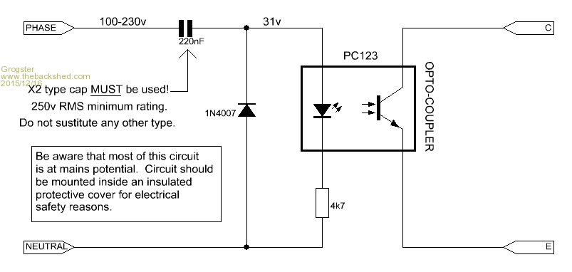

I often need to find out if a source of mains has failed. This is a copy of the circuit that can be found all over Google if you search for "LED on the mains", but with a couple of vital changes - X2 type mains cap and opto-coupled output for isolation.
I guess I should mention at this point, that this circuit is only for those who are aware of the dangers of working with the mains, and who will take suitable safety precautions while working with this circuit. This thread is not intended for anyone not happy and competent working with the mains voltage. There may also be electrical compliance issues depending on where you are on the planet.
The opto-isolated output can be directly interfaced to any MM or other project:
With mains present, the opto pulls the I/O pin low. If the mains fails, the I/O pin goes high via the 10k/1k combination, and this can be detected with your code or an interrupt on the MM series of MCU's.
Placed inside a small plastic box, this unit can provide an isolated NPN output for any project needing to detect when the main power has failed.

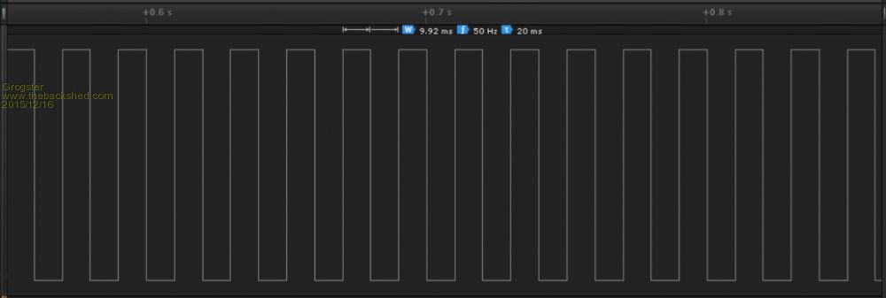

I'm thinking the output is a 50hz square wave.
Is this true ?
John B.
Posts: 10109
Posted: 12:37am 16 Dec 2015
Yes, I would expect so, as our mains is 50Hz. Used in America, the output would be a 60Hz square-wave.
Depending on how quick you are monitoring things, a small cap might be needed across the NPN to "Smooth" things if you are using an interrupt to monitor the pin or it will be forever self-tripping at the mains frequency....
EDIT: Yes, it most certainly is.....
I expected that to be the case though.Edited by Grogster 2015-12-17

This circuit, as the most of capacitiv Power Supplies, is missing a MOV in the input between neutral and Phase.
This the number 1 reason for failing X2 capacitors, because of very ugly transients....
Add it to the circuit for safety and stability.
infos Edited by atmega8 2015-12-17
Posts: 10109
Posted: 11:20am 16 Dec 2015
@ jman & microblocks - Exactly right. I have used relays with 230v coils before, but they tend to run hot when running all the time, and they DO fail as microblocks has said. However, that is certainly an option I have used in the past.
@ atmega8 - good point, well made. I will add one.
atmega8
Joined: 19/11/2013
Posts: 738
Posted: 11:37am 16 Dec 2015
Furthermore, please put a resistor of 2k2 in Series with the poor and stressed X2!
Also parallel resistor to the X2 is a Must ( 1 MEG )
Posts: 10109
Posted: 05:02pm 16 Dec 2015
Why is the X2 stressed?
An X2 cap is rated to be connected directly across the mains, so I don't see any obvious stress issues.
Or are you referring to what happens to it during a transient condition?
Why is the 1M in parallel with the X2 a must?
It isn't here - perhaps your regulations are tougher though....Edited by Grogster 2015-12-18

atmega8
Joined: 19/11/2013
Posts: 738
Posted: 08:21pm 16 Dec 2015
The Microchip pdf is exactly The one i referenced under the info link.
Here are the answers for brave Grogster in theory and Praxis ;-).
The First design is dangerous the chance for a failing X2 is very high.
The electrical shock by touching the Main plug Leads directly to jail....
