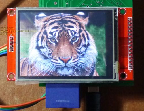

I've implemented basic SDcard functionality for the 28 and 44-pin Micromites that is fully compatible with V5.0 and, of course, make the "C" source openly available:
2015-12-01_195655_SDCard.zip
This is a first beta so may have bugs. It has been tested on 44-pin MX170 but should work without changes on a 28-pin chip - feedback appreciated.
This is based on ChaN's PetitFAT library with the code modified to work in a CFunction and with hardware drivers I have developed to work on the Micromite. The code ONLY supports SDHC cards formatted in FAT32.
It is important to understand the major limitations of the PetitFAT system. Data can only be written into pre-existing files. So to use the code for logging, a large empty file should be created and stored on the SD card. This can then be written into by the PetitFAT code. Files and/or directories cannot be created or deleted. When stored as a "library" the code takes 8k.

The first demo program contains the code to write an image saved as a binary .PPM file to a ILI9341, ILI9163 or ST7735 display. The tiger image saved as a .PPM is included in the ZIP.
2015-12-01_200228_sdpics.zip

buffer$=buffer$+addbuffer$
if (StartX%+width%>MM.HRES) OR (StartY%+height%>MM.VRES) then
print "Picture too big", width%," x",height%
else
Result%= SetRegion(StartX%, StartY%, width%, height%)
Result%=DisplayBuffer(Buffer$)
Buffer$=STRING$(255,chr$(0))
do
Result%=SDcardSPI1(fileheader(),readfile,buffer$,-1,255,NumBytes%)
if numbytes%<>0 then Result%=DisplayBuffer(Buffer$)
loop while NumBytes%<>0
endif
else
Print "Invalid File Format"
endif
END sub

Dear Matherp,
Thanks to the modified program, it works perfectly. The tiger is beautiful. My question is to be used for data collection purposes is the same solution. I apply given the SPI2 solution using BASIC program if the replaced part C function? I'm sorry, but I can not in C programming.

Dear Matherp,
I tested the programs, but I have a problem:
Here is the begin of the testprogram:
option explicit
option default none
' Version to use the standard SPI port on the Micromite
DIM I AS integer, P$(20) AS STRING length 20
const mount=0
const fileopen=1
const readfile=2
const writefile=3
const SD_CS = 4
P$(1)="tiger2.ppm"
P$(2)="chipcad.ppm"
P$(3)="tiger2.ppm"
P$(4)="chipcad.ppm"
cls
do
FOR I=1 TO 4
CLS
VETIT P$(I)
pause 2000
NEXT I
loop
SUB VETIT K$
? "IN: ",K$
displaypicture(K$,0,0)
? "OUT: ",K$
END SUB
and the result:
> RUN
IN: tiger2.ppm
OUT: iger2.ppm
IN: chipcad.ppm
OUT: hipcad.ppm
IN: tiger2.ppm
OUT: iger2.ppm
IN: chipcad.ppm
OUT: hipcad.ppm
IN: iger2.ppm
The first characters are vanished! (displaypicture is wrong?)
where I made a mistake?

The fileopen call in the CFunction converts the Basic formatted string into a "C" formatted string. I could fix this but it just adds code.
The workround is to copy the filename into a scratch variable before calling displaypicture
FOR I=1 TO 4
CLS
scratch$=P$(I)
VETIT scratch$
pause 2000
NEXT I

Also I had some problems with using the SD functions on the LCD Backpack. When I use OPTION LCDPANEL ILI9341, LANDSCAPE, 2, 23 with the Touch disabled and SD_CS = 6 I get "Unable to mount Disk". How do you set up the LCD Backpack for SD functions?Edited by micronut 2016-04-02
micronut
Joined: 03/09/2014
Posts: 37
Posted: 03:52am 01 Apr 2016
I did a little research and found that the SD Card SPI pins are the 4 hole header on the opposite side of the display.
Geoff had enough fore thought to put the SPI connections on the breadboard compatible header. That makes things much easier. All I have to do is solder a 90 degree male header on the LCD and I'll be good to go.
