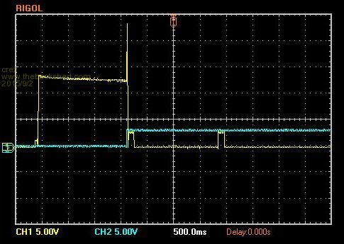

The MCLR(yellow) and VDD(blue) pins of the programmer do this:
but the 13v peak only happens on the first CONNECT command after the USB is connected. Subsequent CONNECT commands behave as they should. These readings were taken with nothing connected. With a 4k7 load on the MCLR to GND, the peak is much shorter but still way over 3.3v
As a precaution I have added 3.3v zeners between all the lines and GND. I also issued a connect command before connecting the target, and it seems the latest programming attempt has been successful. I also have a arduino mini on it's way so I can try Rob's method.
