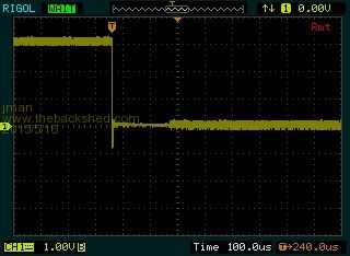

This a look at the waveform when pressing the button all the pins display
pretty much the same if not identical

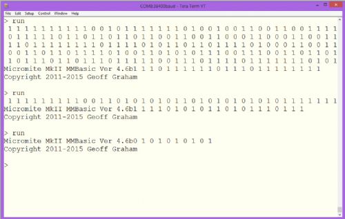

Thirdly I can confirm the reset issue but it is nowhere as bad as you are experiencing.. See the below screen capture
That is running this code
SetPin 25,din
mik:
Print Pin(25);
Pause 250
GoTo mik
The first Reset occurred after approximately 59secs (each line is 10seconds long).
That was about 1second between presses.. the next couple of times I went madly and random speeds pressing the button and it occurred after 18 and then 8 seconds.
So ultimately it is CONFIRMED ... but I cannot get the 95% resets you are experiencing.. mine is more like 5% resets but still that could be enough to upset your program if it was released into the wild.
