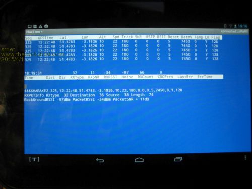

And here it is working, the MMII LoRa receiver is receiving LoRa packets from the transmitter (test data).
The receiver sends the data to COM2: via a HC-05 Bluetooth adapter to an Android tablet (Hudl) using VT100 terminal emulation control codes.
The Android 'App' is Blueterm, which unfortunatly does not support the full set of VT100 codes such as save and restore cursor, clear screen and set scroll area do not work, but work arounds are possible.
