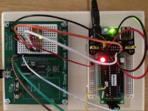

This post is a status of the work I've been doing related to the FPU64 coprocessor from MicroMega. I've been trying to understand how to interact with the chip as well as writing double precision functions that reside within the chip.
The following is a picture of the setup that I'm using. The BASIC STAMP 2 micro-controller is used to communicate with the FPU64. This is done via a USB Homework Board which is on the left in the picture. The small breadboard on the BS2 board contains a USB-to-TTL board from WhiteWizzard. It is used to communicate directly with the FPU64 chip. On the right side of the picture is a power supply and the FPU64. The power supply provides 5 volts for the BS2 and 3.3 volts for the FPU64.
The BS2 board contains a USB interface which connects to a Windows 7 PC. Communication between the BS2 and FPU64 uses the SPI interface.
The following are two double precision functions that are programmed into the FPU64 flash memory. It is possible to interact with these functions using the "interactive compiler" feature of the FPU64 IDE. This helps with debugging user-defined FPU64 functions.

The following is the output displayed by the BS2.
Julian and Calendar Date Example
uM-FPU64 r411
Julian Date 2457128.8754895
Calendar Date
4.0
16.3754894998856
2015.0
done
My next effort is to determine how to interact with the FPU64 using the SPI commands of the Micromite. Naturally, any help is appreciated.
