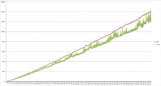

An interesting diversion and a surprising results graph. It seems the comb sort starts to become erratic at around 1000 items, so I am running again with just the CR2 & comb sorts at 2200 items, just as an academic exercise.
results in the morning. zzzzzEdited by CaptainBoing 2017-08-12

It's interesting how the CR2 sort's curve is very 'noiseless' compared to the comb sort and the 'baseline' of the comb curve is sort of even compared to the 'noise' above it. I guess if your code needed to know pretty closely how long a given no of elements would take to sort then CR2 might be the way to go, whereas it seems 'comb' is the quickest overall - albeit marginally.

Posted: 08:28pm 12 Aug 2017
CR2 vs Comb time comparison
Comb is faster overall but I think the the graph demonstrates the interesting phenomenon of "worst case" order. A number of searches suffer from this but it is rarely likely to be a problem in real life, just unlucky if it is.
better resolution is available at the bottom of this article.Edited by CaptainBoing 2017-08-14

This is a test program for comparisation Comb vs CR2 sort.
Something to play with:
2017-08-13_114417_TBS_Comb_vs_CR2_Sort.zip
I hope, that makes things a little bit clearer ...
Michael
The lone and ...
Posted: 02:06am 13 Aug 2017
Final words on the comparison: here
@twofingers Yes I have seen that in action too but can't really pinpoint the reason. I thought it might be because of the single precision nature of the maths too (the originals were double). However...
As this experiment has proven, there are better methods so beyond the academic exercise, there isn't much point in trying to iron out the problem please feel free to update the wiki though if you want to. I will edit the article to highlight the sort failure tho' just to stop it being used.
