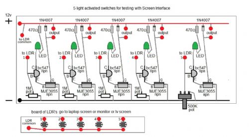

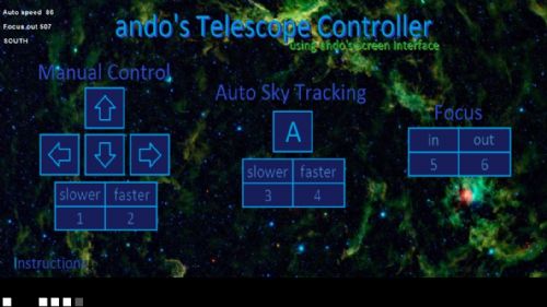

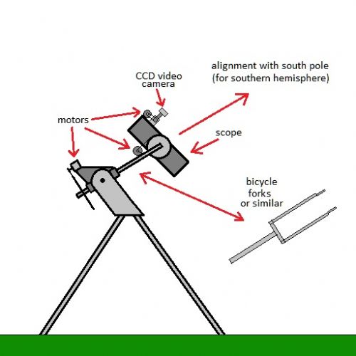

Hi all, this is my first post and I've got to say I am very happy that I found this forum.
I would like to show an idea I had years ago when I was playing with the commodore 64 and I needed more output ports.
Now I'm using a windows laptop and one of my WIP projects is controlling my telescope while I'm inside where it's warm and no mozzies. hehe...
It's very simple really. Just by turning little white squares on and off that are lined up with light dependent resistors as part of light activated switches, it can be easy to control many outputs. And by just varying the brightness, fully variable control is possible too.
Here's some pics. :)

ando
Joined: 05/12/2014
Posts: 6
Posted: 03:36am 08 Dec 2014
OH NO... who let Prime in? hehe...
When I was driving the 4 stepper inputs directly from screen to light activated switch and then to motor, I could only get about 3 seconds per rev and I think the main limiting factor is the time it takes for the light dependent resistors to change from high to low and low to high. Roughly 40 ms.
So if I want fast steppers, indirectly through stepper circuits seems the only way.
I bought all the parts for PWM setup so I'm looking forward to getting that together for some fast and more importantly slow tests with dc motors. Just by dimming one of those squares to make it run slow hopefully with good torque.
Actually, I think the kind of slow LDR change rate has the good effect of making the light activated switch not really being affected by screen refresh rates. I mean, if it's on, it stays on. No chatter.
So it's good for switching lots of things on or off individually but not good for switching something on and off at high speed.
