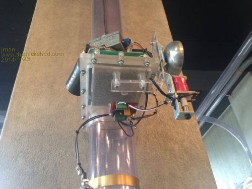

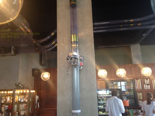

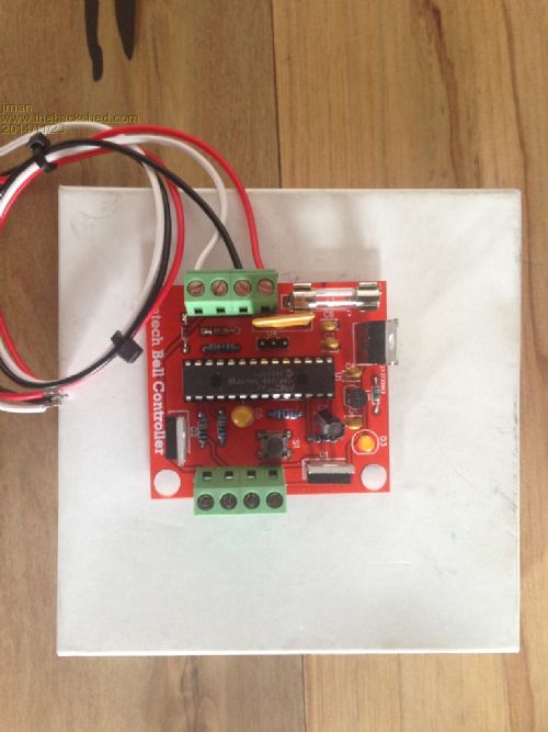

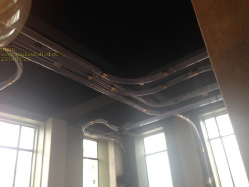

I thought I would share this project we did for a local café in Christchurch.
This café has a unique claim to fame in that they have a pneumatic menu ie
your order is delivered via an air blown tube system.
The café has retro look and feel and this was part of the brief that's why
the PCBs are exposed so you can see the working bits. The bell that signals the arrival of your food is a genuine part from a Pinball Machine as are the globes
that light up the tube when your order is about to leave the kitchen
Take a look at the video
C1 Video
This has been in place for a while now and is running on the MX150.
The software is setup for each station as the food travels at different rates
depending on the length of the tube. The Micromite takes care of announcing the
departure and arrival of the order. (Bell lights etc.)
But all in all a cool use the Micromite
A few pics of the setup below
C1 Cafe
