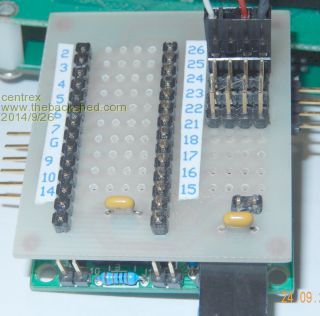

I like the idea of a little fram board to plug into the I2C socket of the MuP.
The RTC in the Fram doesnt matter as I already use the PCF8563 RTC module which works no problems.
I personally would prefer small plug in modules for connecting to the MicroMite and to this end I made myself a board the same size as BigMicks MuP that allows me to connect what I want.
This board plugs directly into the MuP and gets as well as all the i/o pins the 5volt supply from the I2C section of the MuP.
I have not fitted all the pins to the i/o as yet but the MuP is running the RTC, 4X20LCD, BMP085 and a DS18B20.
Hopefully in the very near future a FRAM memory module.
As an aside the temperature sensor in the BMP085 that I have does not appear to be very accurate compared to the DS18B20 and every other thermometer I have.

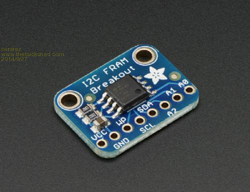

Adafruit has a FRAM breakout board I2C 32Kbytes all for $10 us, all we need is someone to write the software to suit the MicroMite, not my field of expertise.
Probably many others on the market, but it does make it easy to get started.
Heres hoping.
Cliff

@ panky - even though the FRAM chips seem to support up to 1Mb bus speed, I don't think that the uM chip can go any faster then 400kHz. We'll have to check on that....
EDIT: Sorry, I misunderstood you - you meant the 1Mbit capacity chip(125KB) I think.
@ centrex - can you please post a link for that module you put up the photo for?
FRAM chips SHOULD be even easier then standard flash EEPROM to use, as there is no polling or page boundaries to worry about. Just as with a normal EEPROM that you can sequentially read from the start to the end of the memory, you should be able to write data to the FRAM just as fast, and without keeping track of pages, boundaries or write delays. Those are the things that sell it for me. ;)

Google ADAFRUIT FRAM it will be in the first couple of items.
https://learn.adafruit.com/adafruit-i2c-fram-breakout/overvi ew
To me this is the simplest way to go.
Cliff

I'm inclined to agree, for the purposes of bench-testing, anyway.
Here is a clickable link to the FRAM Module
I think I will get a couple, and run some tests. The sequential writing tests are the ones I am interested in, but the fact that you can grab any address and start writing from there without ever caring about page boundaries is heaven for me.
