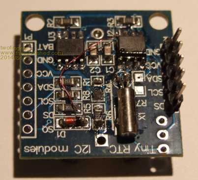

Yes. My DS1307/PCF8563-modules drifts about 0,5sec/h. The DS1307 consumed 2,2µA, including die voltage divider.
To test the PCF8563 (and Geoffs great improvment RTC GETTIME/SETTIME) I just cutted the DS1307 out and replaced it with a PCF8563 (10 pieces for 1,7 EUR at ebay). PIN 3 = NC. PIN 8 = D1/R6. It takes about 0,5µA (without R4). I did find no way to correct the drift.
The image above shows a DS1307-module with a replaced PCF8563 (DS1307<->PCF8563).
eBay-DS1307 modules - the schematic - are made for lithium accus (LIR2032) but often sold with a CR2032 battery.
The DS3221 seems to be the able to tune its frequency by software. But 2ppm is enough for my purposes.
