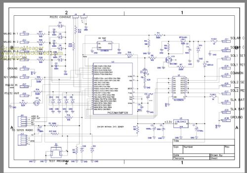

What would be the chances of you uploading a photo of how things are connected up?
That, or a schematic diagram - just freehand pen and paper would do...

The schematic is close to being accurate, I have made a few modifications over the past few days.
Posts: 10106
Posted: 10:32pm 28 Jun 2014
Thanks, Graeme.
Could you please put the photo and the schematic into a ZIP and post that?
Not your fault - forums have re-sized the schematic so much so, it is unintelligible.

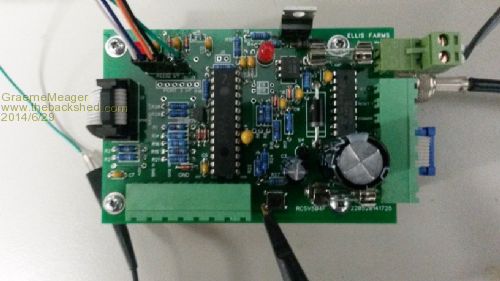

EDIT: Your PCB looks fantastic, I must say....Edited by Grogster 2014-06-30

@Grogster I'll try again:
2014-06-29_092718_RCS_REMOTE_SCHEMATIC.zip
2014-06-29_092923_pcb_2.zip
PS Grogster this project is a love job I have taken on for my brother-in-law on his farm. An upgrade to a system I installed many years ago, it is times like this I wish I hadn't said yes.

Yes, very nice PCB indeed.
At first glance(and I have not had an in-depth look at it yet), I don't see anything obviously wrong electronically, based on your schematic. I will keep a close eye on this thread, and see what others come up with.
As to the wishing you had never said yes, well - most of us here have ALL had that at some point, but it really is time for drinkies(alcoholic or not, depending on your stance) once you finally crack what the problem is, so do hang in there, as we all do want to find out what the issue is - if that is not being to presumptuous of me with respect to the other members of the forum!!!
I am GUESSING that you tested this out on a breadboard BEFORE you got the PCB done, so can therefore be reasonably sure that it should have worked?
EDIT: Looking at the schematic - do you really need 1000uF on the 3v3 rail? Seems like rather a-lot to me... If the radio works on 3v3, then the cap should be on the radio-side of the PSU, not on the MCU side of the PUS. My 2c only.... Also, 4700uF on the input to the regulator? OK if the MCU was to be sucking a couple of amps, but it won't be.Edited by Grogster 2014-06-30

Could you try removing R13 (the 1k resistor in the speaker line) or short out D11.
This effectively removes the audio without changing anything else.
If the micromite no longer resets, I expect that you are overloading the analogue inputs.
The 1N746A has a fairly large forward voltage drop (but I couldn't find a low current figure) and that might be upsetting things when the input goes negative. A resistor after the diode, between the diode and pin 25 should be enough to fix that problem. Without a resistor, the diode is in parallel with the internal protection and the internal is probably doing all the work.
A Schottky diode in parallel with the zener might also work.
You appear to have good protection in your circuit and there looks like a 0.1uF cap close to the analogue supply pins. The analogue ground is important and a re-arrangement of the ground traces might be needed. This is getting into an area which seems like black magic and not my best area. I usually put in lots of isolation transformers and relays or opto-isolators for the PTT.
