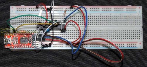

Hi Max,
  Quote  EDIT: I found this 2014-09-08_164736_rpipic32.zip
Is this the most recent program for the Pi?
AFAIK: yes!
There are also versions for Linux and Windows (2014-08-17_211335_ftdipic32.zip).
Peter (G8JCF) made a nice version for Micromites (you have to own a programmed Micromite).
I guess this picture should show Johns method.
I tested Johns Windows code. Works, but is very slow (>10h). For whatever reason.
And i like Peters code on a breadboard. It takes - on my conditions - about 4min to program a Pic32MX170.
I think this thread is almost unreadable (to many post), especialy for newbies.
Btw. Thanks to Peter (G8JCF) and John for their efforts!
Michael
