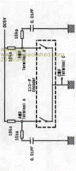

I debounced it this way:
If you don't rotate to fast it is ok.

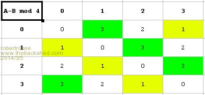

Posted: 07:12pm 04 Mar 2014
btw, the logic i used was based upon the following map:
green and yellow represent the two different directions of rotation, while white cells are the 'illegal' states where a transition has been skipped.
