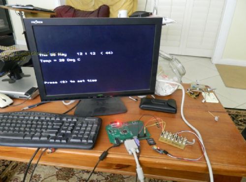

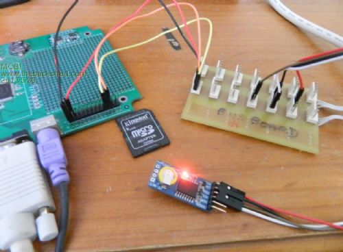

Posted: 04:50pm 29 May 2013
Here's a pic of my set up.
David M.
