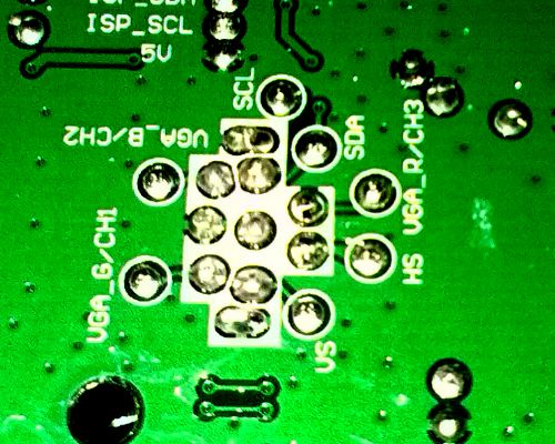

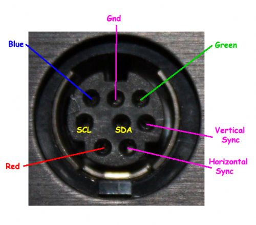

OK lets try to get this going, several hours with doctor Google revealed nothing about the pinout for the VGA cable (although I did find that DX.COM has them with the cables included) so I bit the bullet and disassembled it and nearly fell out of my seat when I saw the back of the connector was labelled.
See
Or a clearer one I did showing the pinout (looking into the 8way minidin connector)
The male plug to suit is available from JAYCAR Cat: PP0370 for a massive $1.95.
15min later and I had me a neat little VGA to TV-VGA cable..

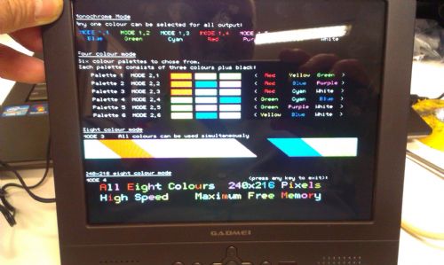

The picture quality was MUCH better than I expected it to be, the screen is basically stretched to fill the entire screen (albeit everything with the usual left shift) and most colours and text is very clear some text was slightly blurry due to the emulation to display the MM on a 800x600.
The left hand character is half off the display area (but better than most screens I have used), unfortunately there doesnt appear to be an electronic adjustment but I am more than happy with this TV for only $58US...
There is no shimmer and the COLOUR-2.BAS demo looks absolutely beautiful.
EDIT ** The 2 unused holes are labelled SCL and SDA so I assume that these must be for software firmware updating the TV...

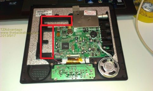

When you removed the backcover did you find that there is some free space?
I would like to be able to put in a small pcb (50x60mm) and a usb type a connector and change that tv into a Colour Maximite all in one. :)

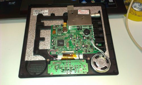

I have it here at work If I get the time I will pull it apart and post a pic for you...

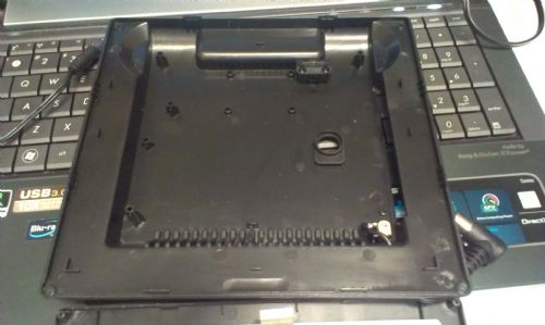

Here are some pics from my mobile phone (reduced Quality for TBS as they are 2.5M each)
Here is a (very poor) screen shot to show the full size (800x600) emulation the TV does... also you will see 1/2 of the lefthand character missing.
The colours are up the poo , very strange, If I rotate my phone 90degrees some come good but others change to whitish... trust me the colours look great and correct.
EDIT *** Those Pics got reduced MUCH more than I did here they are in ZIP files
2013-05-17_112634_Inside.zip
2013-05-17_112651_screen.zip
2013-05-17_112707_Shell.zip
Mik

Posted: 01:59am 17 May 2013
Thanks a lot for the pics Mick.
I think the areas marked in red are big enough. Even the UBW32 will fit there i think.
Off to DM to order one. :)
Hi TZ,
The UBW32 would certainly fit... the 50mm wide you want will be touch and go but I reckon you could get it in (99% sure you could)..

  bigmik said  EDIT ** The 2 unused holes are labelled SCL and SDA so I assume that these must be for software firmware updating the TV...
Those 2 pins are the I2C interface for monitor identification
"Extended Display Identification Data "
This is what is used to set the resolution of your display
If you connect them to you PC's VGA port (pins 10 and 12)
your PC should automatically set the screen res accordingly and
identify the monitor type
