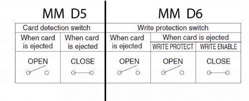

  aargee said   I'm pretty sure the "write protect" and the "SD card present" switches are active low. You can hard wire them if you like, the MM software will then assume a card is present.
I think you will find `WP' is active HIGH..
Ie. If high then write protect, If low then Write enable
See table below
Edited by bigmik 2013-03-08
MOBI
Joined: 02/12/2012
Posts: 819
Posted: 09:16pm 06 Mar 2013
@Mick
I guess then that D5 and D6 have internal pull ups as the WP and Det only connect to ground.
All the conditions in the table refer to when card ejected - I'm a little confused.
I can't see that I'll do any damage by tying the D5 and/or D6 low without the card in, so I'll experiment and see what errors come up. Just as well I have headers to plug into.
Don't know why SD card holders (except for pins 1 to 9) have to be so different wrt wp and det.
David M.
Posts: 2984
Posted: 11:53pm 06 Mar 2013
Sorry David,
Yes that is a very bad example, I apologise, I saw it in amongst the many data snippets I have from when I designed the UBW32-MCC PCB and didnt read it properly.
Basically the D5 and D6 pins have internal pullups and the D5 is LOW when card is INSERTED and HIGH when EJECTED.
D6 is LOW when Write ENABLE and HIGH when Write Protected.
The uSD socket I selected for the UBW32-MCC only had one switch for card present so I linked both D5 and D6 together as uSD cards dont have a WP switch. You can safely just short D5 and D6 to GND but I dont know what the MM would do if there is no card inserted.
