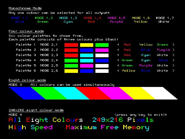

This is what the modes look like at this time (this could easily change as development progresses). The colours look beautiful on the screen, it is a pity that they have lost something in this image:
Note that when you change modes the whole screen changes, this demo was fudged with the screen in MODE 3

The bad image quality, the forum resizes JPG's down to 500 pixels to save bandwidth. If you save as a GIF and it will resize to 1000 pixels wide, but only if the image is bigger than 1000 pixels. GIF's are better suited to images with detail, like circuits, code, etc, and less than 256 colours.

  Gizmo said  GIF's are better suited to images with detail, like circuits, code, etc, and less than 256 colours
Thanks, hopefully this will look better...
Remember that this is a work in progress, anything can change.
