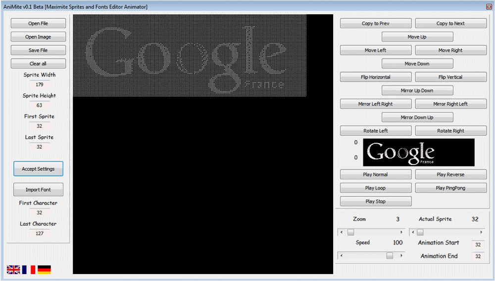

The new version accept ONLY *.bmp pictures ! , only black and white pixels
are decoded.
Also convert your pictures in B&W before you use the Animite.
Here one example i do for testing ...
and here ... the new version from the soft :

I improved a little the Animite to be able to load more
pictures format.
Now we can load : bmp , gif , png and jpg
Here is the new version :
2012-01-09_020557_Animite.zip
