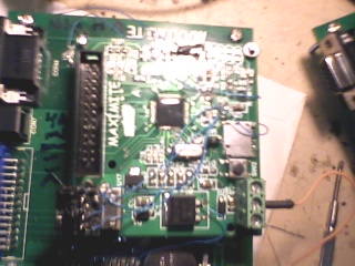

i am updating to 2.7A. is the boot load button on the maximite the button marked sw2? (the only button on the board). what voltage has to be applied to the terminal marked '+' and the ground terminal?
is it quite safe then to plug in the usb cable between the pc and the maximite.
i am trying this first without downloading the microsoft software for windows xp.does the update usually work without downloading this software? thanks guys.

  peterclarke said   i am updating to 2.7A. is the boot load button on the maximite the button marked sw2? (the only button on the board). what voltage has to be applied to the terminal marked '+' and the ground terminal?
Answers -
1. Yes, the only button on board is the Firmware load button.
2. I don't know what voltage you are talking about - you do have the original Maximite?
3. What Windows software are you talking about? you don't need any special drivers to load the firmware, just the bootloader program from Geoff.
Please try and ask clearly what you want to know.
- Rob.

peterclarke
Joined: 09/11/2011
Posts: 3
Posted: 09:14am 14 Nov 2011
to sparkey and aargee,
yes sparkey i have been to geoffs website about updating the maximite. the instructions also say that you may not need the net framework and if you look at the reply below yours aargee says that you only need the bootloader program from geoff.
also the instructions state very clearly to power up the maximite and press the bootleg button before connecting the usb cable to the pc.
yes aargee right next to the bootleg button(sw2) on the left is a voltage entry point. the instructions don't say what voltage should be applied here.
and further down in the instructions it says after loading the update to disconnect and then reapply the power supply on the board for the update to take effect. it does not say disconnect the usb cable.in fact if the usb cable is disconnected with the computer running could be disastrous. i did this once and thought i had lost everything. a computer technician managed to get everything back for me. i will never do it again.
so sparkey you see that a proper interpretation of the instructions is that the board is powered from 2 sources at once which i also found peculiar. and i also don't like making additional work for myself by downloading unecessary software. aargee says it is not necessary.
the instructions i am talking about come with the 2.7A update in a file called 'Loading New Firmware'.

centrex
Joined: 13/11/2011
Posts: 320
Posted: 10:02pm 14 Nov 2011
Hi Peter
From what I read I believe you are using the Dontronics SM1 board.
The power into the + - terminals can be anything from 9 to 12 volts.
One feature of the SM1 board is that it can be powered from the usb or an external source automatically you do not have to move jumpers as required by the origonal circuit.
When I upgraded my SM1 to 2.7 I followed the instructions that you already have, with no problem, I was using a laptop running Vista.
Just remember to reboot the device as per the instruction you will have to switch off the external supply and remove the usb cable, then switch on the external supply and you should get the normal boot screen telling you that it is version 2.7.
If you do not remove both supplys the SM1 will just keep on running in the update mode.
Hope this is of some help
Cliff
