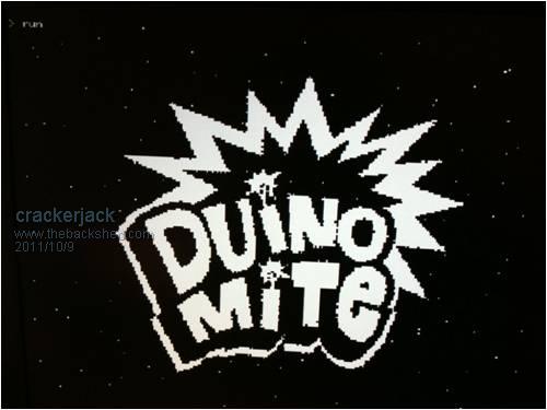

Hi All,
I have a small program that allows me to display bitmap images loaded from the SD card. Of course monochrome images no larger than 480x432 pixels are the limit (and it is painfully slow), but it was a fun exercise learning about the BMP format and how to read it from a file & decode it using MMBasic. Attached is a photo of a bitmap loaded from the SD Card (Don, I hope you don't mind me using the Duinomite logo as a test case). It may be of some use if you want to display small images as splash logos, etc.
If anybody is interested, I can post the code (I'll have to clean it up a bit first).
Lance.
Actually it is an Olimex generated Logo, but I'll stick my neck out and say they are more than happy for you to use it.
Nice work.
Cheers Don...

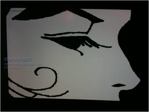

crackerjack
Joined: 11/07/2011
Posts: 164
Posted: 08:31am 11 Oct 2011
Just for the sake of completeness - here is a final version - refactored somewhat now that I better understand the BMP format's padding spec.
There are some diagnostic details still printed by the code which could be removed to make it more compact (since the CLS at line 280 wipes them out). 5% of program memory is used by this version of the code.
I am thinking there may be a better, more quickly rendered format for raster graphics specifically for the Maximite... I may look into what this could be. Code follows along with another screenshot.

Posted: 12:10pm 17 Oct 2011
Hi All,
Just in response to the Olimex post from a week or so back - I did look at JPEGs and very quickly decided to look no further. The JPEG compression algorithm is complex - vastly complex for MMBasic and the Maximite's processing power. Apart from that, the Maximite has 1-bit, 480x432 graphics resolution which could not really offer much in the way of rendering images from a JPEG which I don't believe goes much lower than 8x8 grayscale.
Since the Maximite can generate it's own Bitmaps to file with the SAVEBMP command, I thought I'd stick with that. My experiments at getting the Maximite to be used to display some basic graphics in the form or rendering monochrome Windows Bitmap (BMP) files showed that it was hopelessly slow rendering the bitmap pixel-by-pixel. I spent a little time thinking about it and decided there was possibly a way to render images in more reasonable time-frames. The following is what I have come up with. For those who feel less inclined to read about the details and just "have a play" - a zipped file with the MMBasic code and a README file can be downloaded here.
Essentially, by converting the BMP files into what I have dubbed the "Maximite Picture Format" (MPF), the results are encouraging and I think nifty Splash Screens or even games using bitmapped graphics might be feasible. Some stats to illustrate the results:
A single 400x328 pixel image (the "Face" image in my post above) previously rendered in over 50 seconds as a BMP, while as an MPF, the same image is rendered in slightly more than 1 second. The file size is reduced from around 18kB to just under 4kB.
The boring details follow (some may care to know)...
The 2-step process explained:
1 -> Convert the BMP files to a format more readily renderable in MMBasic. Maximite Picture Format (MPF) works as follows:
A program (BMP2MPF.BAS) validates and reads an ordinary monochrome Windows Bitmap file (of dimensions no greater than 480x432 pixels). The data is encoded using a modified Run Length Encoding algorithm such that horizontal "runs" of alike pixel "colours" (black or white) are counted and written out as count/colour pairs. For example, 10 pixels of white followed by 27 pixels of black would be encoded as (10)1(27)0. The count values are written as single byte ASCII characters rather than decimal numbers. Of course a maximum count of only 255 is achievable using this method, hence a modified algorithm to take this and the image width into account. The result is a vastly smaller file (in most cases) which really contains information about the image in a "horizontal vector" type of format. Actual image details will cause variation in file size differences, but the results I have had are MPF files in the range of 80% - 90% smaller than the original BMP file. It is of course possible that an MPF file may be larger than the original BMP file if the image is say of a grey dithered pattern. There is really nothing new about RLE.
2 -> Decode the MPF file for rendering, as follows:
The program MPFVIEW.BAS simply reads the Run Length Encoded data from an MPF file, and then using the MMBasic LINE(x1,y)-(x2,y),c statement, renders the vectors in a series of horizontal lines (bottom up) to create the image. MPFVIEW basically shows the decoding algorithm. It takes up less than 1KB of program space and is simple enough to use in any larger program to render previously converted images (either from SD card file of even from an in-memory array).
It's quick and pretty easy to use. Converting an image from BMP to MPF can take a while, but this only needs to be done once for an image.
I hope this is of some use to somebody and inspires some ideas as to what more this great little machine can do.
Cheers,
Lance.
