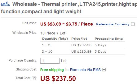

Those are for Don. If I try to buy one, the price is per lot:

Hi Vasi,
That is only one supplier.... they only sell in lots of 10... check out other suppliers some will sell in one OFF.. it is Chinese open market so it is 100's of sellers competing... some offer free freight (but unit cost is higher) some offer outrageous freight (I have seen $1000 US for a $50 item)
It is buyer beware but some great bargains can be had.
Mik

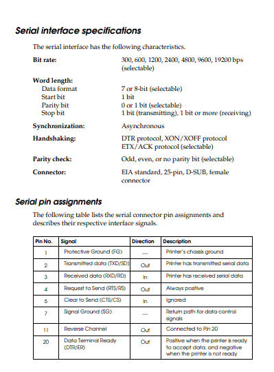

G'day Guy's,
Well after trawling thru page after page looking to see just how many code examples there have been and I do have not very many at all I came across this old thread. So I had to go upto my shed and check out those old LX300 dot matrix printers I got from the road side collection a few years ago just to see if they would worth a go at hacking and for a play see I can get a DM-mega to get some life out of it.
I found the User Manual for the printer and YES it can be driven by serial so I'm going to make a DB25- to DB-9 connector and have a play. I also found the pinouts for making the serial cable on the Epson site so it won't be a hard task to make one up. I may have to make up a RS232 board so I can get true serial data and that would a cool job for the Arduino setup. Well going from the help file to tinkering with an old dot matrix printer.... And who said these Duinomites ain't fun......
I do have atleast 3 and maybe 4 of these printers here so if I can get a bit of life out one I'll have to send one over to Don and Mick to have a tinker with
Cheers Bryan
P.S. Further reading on this printer it only needs 3 PINS for serial RX,TX and DTR(which is just a ready/busy signal from the printer) so I reckon I'm goingto have some fun with and the 'print' command could end up taking new meaning......
