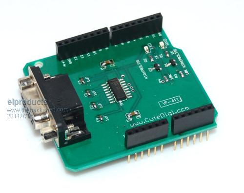

elproducts
Joined: 19/06/2011
Posts: 282
Posted: 09:50pm 15 Jul 2011
  donmck said
  aargee said   For those interested in Serial Bluetooth comms...
Looky there
Have a a close look at the title, and try and think how you would mount it..
- Rob
Arduino Shield?
Is there a current UART and Bluetooth, to Arduino Shield available already?.
This may be the simple answer to mounting it.
Cheers Don...
YES, several. Here are examples.
RS232 Shield
BlueTooth Shield
There is a list of links to shields at the link below.
Shield List
www.elproducts.com
