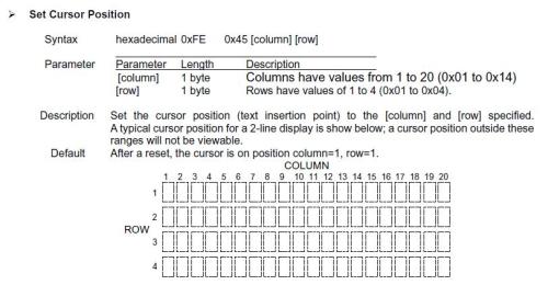

LCD Rows/ Columns this should explain
RayB from Perth WA
