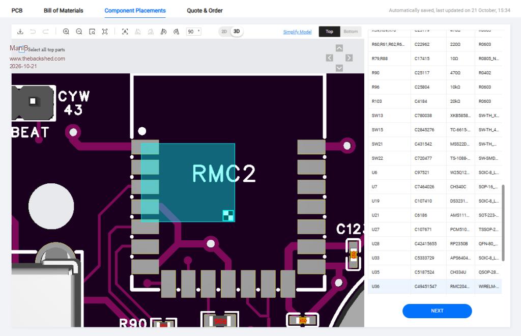

Added question: What's abot the placement of RMC2. It looks faulty.

I've built 3.3 and it works perfectly, the keyboard version also uses the same circuit as 3.3. JLC don't have a 3d model for the RMC but the board will be fine.
