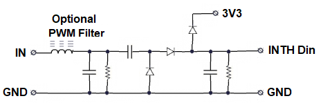

  Quote  Loop that channel back to an AIN pin (via a filter if PWM) to monitor the tones.
Could the signal on the looped back pin be used to trigger the patch switching?
A DIN could trigger an interrupt to do the switching.
The audio control tone, after filtering to remove the PWM carrier, could be AC coupled to a rectifier to trigger the DIN pin.
Edited 2026-08-27 09:57 by phil99
