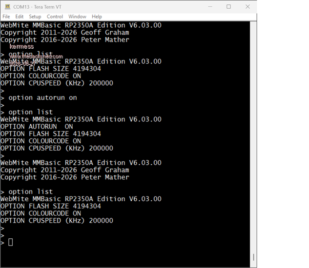

I am trying to understand a behaviour of OPTION AUTORUN ON that I find rather puzzling.
I used this feature some time ago and do not remember having this problem. To check it as
simply as possible, I decided to carry out the test using a new Pico 2W running WebMite
MMBasic RP2350A V6.03.00, with no program, no Library and no WiFi or other peripherals
configured.
The test is performed from the Tera Term console. The attached screenshot shows the
complete sequence up to the point where the board is powered off.
The console first executes OPTION LIST, then OPTION AUTORUN ON, followed by another
OPTION LIST, confirming that AUTORUN ON is correctly shown.
At this point I completely power off the Pico 2W, wait a few seconds, and then power it
on again.
The screenshot continues after the restart. The first thing that appears is the normal
WebMite identification:
WebMite MMBasic RP2350A Edition V6.03.00
followed by the copyright information and the Tera Term prompt.
Without performing any other operation, I then execute OPTION LIST.
In this second OPTION LIST, OPTION AUTORUN ON is no longer shown.
The board has started normally and no error message is displayed.
Should OPTION AUTORUN ON remain set after powering the board off and then back on?
Is this the intended behaviour?
Or am I missing some condition or step in the procedure?
Thank you for any clarification.
 David

Posts: 6252
Posted: 06:33am 27 Aug 2026
Option Autorun is smart.
When you turn autorun on, it executes the code in flash. When an error occurs, it sees the program in flash as corrupt, and will not start it again. The option is reset. It will not show anymore when you do an OPTION LIST.
Since some errors (i.e. in a Webmite, when you do not get an IP address) could lead to reboots this avoids endless reboots.
If you have a program that could error, but you insist in starting it up after a reboot (you don't mind endless reboots) then use
OPTION AUTORUN ON, NORESET
This is used in Game*Mite, where the menu must always show, even if a game crashes.
Edited 2026-08-27 16:35 by Volhout
Posts: 10104
Posted: 11:27pm 27 Aug 2026
  Volhout said  Option Autorun is smart.
Well, there you go then!
You need a code of some sort.  Or OPTION AUTORUN ON, NORESET
Even just a "Hello World" would do for testing, to allow AUTORUN to actually run.
Edited 2026-08-28 09:29 by Grogster
Posts: 3372
Posted: 04:41am 28 Aug 2026
There is a bit of confusion here and I'm not sure quite what is going on, but the following might help.
If the Picomite is powered up normally, or rebooted by the watchdog timer, or by the CPU RESTART command, the AUTORUN ON option will cause the program in flash to be automatically run... we all know that.
BUT if the reboot was caused by a CPU exception the Picomite firmware will ignore the AUTORUN setting, it will NOT run the program and it will clear the AUTORUN setting.  A CPU exception is normally something within the firmware, like trying to access non existent memory or hardware.
This is different from the Micromite which always honoured the AUTORUN option, regardless of what caused the reboot.  The problem with the Picomite behavior is that in an embedded controller it could fall over and the only way to fix it would be to pull it out of service, connect to the console and reinstate the AUTORUN ON option.  Cycling the power will not help.
I discovered this on the early WebMite versions which had trouble in its TCP/IP stack and was always generating CPU exceptions.  Peter's solution was to add the ,NORESET option to act like the Micromite.
I don't see any mention of unexpected reboots in this thread so this explanation might not be relevant.  But it does explain why the ,NORESET option is there and what it is intended to fix.
Also, you can put the AUTORUN ON option in the program.  It does no harm and it is one less option that you have to remember to set.
Edited 2026-08-28 14:52 by Geoffg
