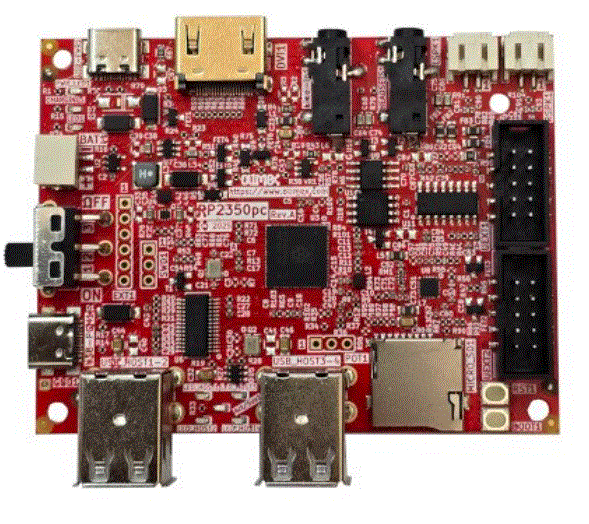

The inexpensive Olimex board works fine with the latest firmware with a Pico2 board installed https://thebackshed.com/forum/ViewTopic.php?TID=18959&PID=256803#256803#256803

IIRC the audio is screwed up pn that Olimex board. It uses PWM but on two different ports so MMBasic can use one channel or the other but not both.

Olimex PR2350 board 24.95 EUR
"RP2350B all in one computer with 16MB Flash, 8MB PSRAM, DVI / HDMI display 4 USB hosts Stereo Audio and UEXT connector"
Is it otherwise compatible?
Posts: 12173
Posted: 01:20pm 23 Aug 2026
Better than some -but....
PSRAM on GP8
No RTC
No console
Audio wires I2S MCLK if needed then audion won't work
