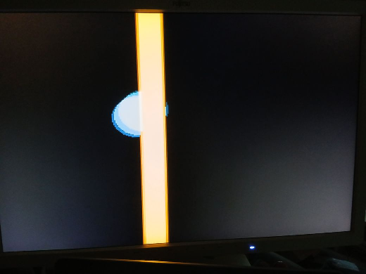

Hi Gerald,
Thank you very much for your prompt reply.
I haven’t changed any of the settings;
  Quote  > option reset pico computer 3
PicoMiteHDMIWEB MMBasic USB RP2350B Edition V6.03.02b1
OPTION SYSTEM I2C GP20,GP21
OPTION FLASH SIZE 16777216
OPTION COLOURCODE ON
OPTION KEYBOARD US
OPTION PICO OFF
OPTION RESOLUTION 640x480 @ 315000KHz
OPTION DISPLAY 24, 80
OPTION HDMI PINS  1, 3, 5, 7
OPTION SDCARD GP33, GP30, GP31, GP28
OPTION AUDIO I2S GP10,GP22', ON PWM CHANNEL 11
OPTION RTC AUTO ENABLE
OPTION COUNT GP34,GP35,GP36,GP37
OPTION MODBUFF ENABLE  512
OPTION PLATFORM PICO COMPUTER 3
OPTION PSRAM PIN GP47
Total of 6 Mbytes PSRAM available
unfortunately, there’s been no change

Martin,
I've just seen that you provided the test-code for the bar/ball example. Tried it and yes, if you issue "option reset pico computer 3" the problem you described is there (ball behind bar).
I've tried it with just the
 option reset hdmiusb
 option hdmi pins 1,3,5,7
and it works as expected (bar behind ball)
So the "option reset pico computer 3" is the root cause. It tweaks something with the layer sequence.
Maybe Peter can correct that. In the meanwhile you have to set all the required options for the PC3 manually.
Gerald
73 de OE1HGA, Gerald

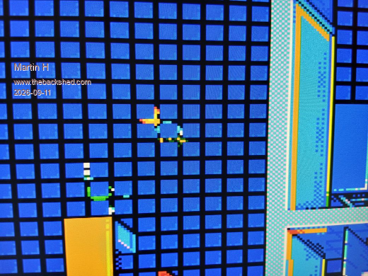

  matherp said  It's possible that there is a bug. Does Petscii run OK? If not will fix.
not really
Here, too, the figure appears behind the background
This concerns MMBasic USB RP2350B Edition V6.03.02b1.
I’ll try out other versions once I’ve worked out how to update the firmware ;-)

Posted: 05:03am 11 Sep 2026
@Peter,
there may be a problem in the visibility of framebuffer L and framebuffer N in the PicoMiteHDMIWEBV6.03.02b3 as L appears in foreground and N in background.
In the PicoMiteHDMIUSBV6.03.02b3 N is foreground and L background, which is what is expected. Seems to be that way since the first release of PicoMiteHDMIWEB.
Can be tested with Martins code:
 Option default integer
 MODE 2
 CLS
 FRAMEBUFFER Layer
 bx=0:by=0:xr=1:bc=RGB(255,170,0):cc=RGB(0,170,255)
 cx=10:cy=10:cxr=2:cyr=2
   FRAMEBUFFER wait
   FRAMEBUFFER write l
   CLS
   Circle cx,cy,20,1,1,cc,cc
   Inc cx,cxr:Inc cy,cyr
   FRAMEBUFFER write n
   Box bx,by,20,240,,0,0
   Inc bx,xr
   Box bx,by,20,240,,bc,bc
   If bx>300 Or bx<=0 Then xr=-xr
   If cx>300 Or cx<=10 Then cxr=-cxr
   If cy>220 Or cy<=10 Then cyr=-cyr
 Loop
