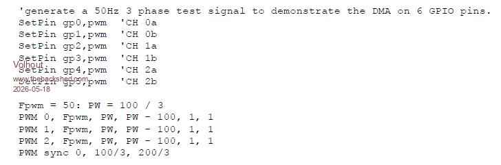

But to drive an H bridge, you often need 2 PWM controlled pulses with 180 degrees phase difference. Then you can use 2 different PWM, that you phase lock. Then use output A from PWM1 and output A from PWM2 to drive the H bridge. You need to use PWM SYNC to start the 2 PWM's simultaneous. Now you can have A a duty cycle of 20%, and B also with duty cycle 20%, but they are 180 degrees appart. The dead time is now also easy to implement: have a maximum duty cycle of 49% (not 50%).
IF you look at example 3 in the user manual appendix F (this appendix is about PIO) it shows in a few lines (Phill's idea) how to create 6 H bridge signals for a 3 phase H bridge from 3 independent PWM's that are phase locked. Note, this is 50Hz, and they are 120 degrees appart.
In this example it is used to demo a simple logic analyzer running on PIO. But the test signal can be used to do what you need.
