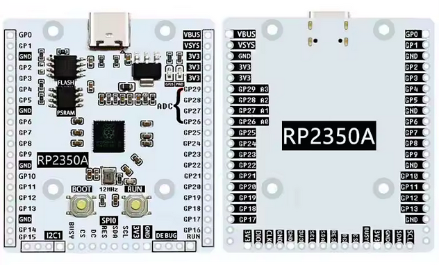

Hello,
I can report that this board runs fine with MMBASIC. It comes with 8MB PSRAM on board and was just 5€ on Aliexpress. PSRAM pin is GP19:
OPTION PSRAM PIN GP19
It is one of the few boards with PSRAM and DIP formfactor, although its almost square

Is it 2.54 mm or 2mm pitch? Those holes look a little close to me.

PSRAM on GP19 is a pain. You can't have HDMI if it's hard-wired 'cos GP19 is HSTX7 pin. Not a great bit of design. :(

The pitch is 2.54 - it fits on a breadboard.
Yes, PSRAM on GP19 sucks. It does seem to overclock well, 384Mhz (maximum with PSRAM) looks stable so far.

I've just heated up an lifted PIN1 on the PSRAM chip...
What is the better pin for the PSRAM chip GP0 or GP8?

GP0, 8 is the default keyboard or com port depending on version

Right, GP0 it is. I rewired the cs pin using my good old wire wrap tool, and now the hdmi pins are free.
