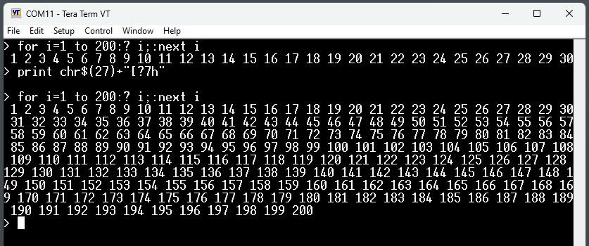

An update on commandline wrapping. I looked at the source and can see your fixes and they seem to be in B5. I can see the ESC[?7h coming back when the editor exits. (MMCC in monitor mode) but it does not seem to restore scrolling.
If I do Print Chr$(27)+"[?7h" at command line it is restored and wrapping is OK.
In the code the ESC[?7h is between a few other ESC sequences I wonder if is not being acted on for some reason.
When not working and you type past the end of the line in the console it doesn't go to the next line.
Do you see this after exiting the editor.

Repeated Rob's test (for i=1 to 200 : ? i; : pause 200 : next i on b4, TeraTerm 5.2) this morning and wrapping worked. Opened the editor then saved. Wrapping no longer working, applied your Print Chr$(27)+"[?7h" at the command line and wrapping is OK again.
So not just you.

  phil99 said  Repeated Rob's test (for i=1 to 200 : ? i; : pause 200 : next i on b4, TeraTerm 5.2) this morning and wrapping worked. Opened the editor then saved. Wrapping no longer working, applied your Print Chr$(27)+"[?7h" at the command line and wrapping is OK again.
So not just you.
Hi Phil,
Its known to not wrap after EDIT  in B4 but checking if fixed in B5.
F4 H7FotSF4xGT
Posts: 3429
Posted: 03:45am 05 May 2026
Line wrap ok after b5 update. No line wrap when running from saved program or at command prompt.
1 2 3 4 5 6 7 8 9 10 11 12 13 14 15 16 17 18 19 20 21 22 23 24 25 26 27 28 29 30 31 32 33 34 35 36 37 38 39 40 41 42 43 44 45 46 47 48 49 50 51 52 53 0
> LIST
For i=1 To 200 : Print i; : Pause 200 : Next i
1 2 3 4 5 6 7 8 9 10 11 12 13 14 15 16 17 18 19 20 21 22 23 24 25 26 27 28 29 30 31 32 33 34 35 36 37 38 39 40 41 42 43 44 45 46 47 48 49 50 51 52 53 54 55 56 57 58 59 60 61 62 63 64 65 66 67 68 69 70 71 72 73 74 75 76 77 78 79 80 81 82 83 84 85 86 87 88 89 90 91 92 93 94 95 96 97 98 99 100 101 102 103 104 105 106 107 108 109 110 111 112 113 114 115 116 117 118 119 120 121 122 123 124 125 126 127 128 129 130 131 132 133 134 135 136 137 138 139 140 141 142 143 144 145 146 147 148 149 150 151 152 153 154 155 156 157 158 159 160 161 162 163 164 165 166 167 168 169 170 171 172 173 174 175 176 177 178 179 180 181 182 183 184 185 186 187 188 189 190 191 192 193 194 195 196 197 198 199 200
> RUN
Adding the fix to the first line of the program restores line wrap when RUN or at command prompt.
> LIST
Another quirk, LIST prints PRESS ANY KEY always, even for a 1 line or 0 line program.
> list
PRESS ANY KEY ...
Line wrap doesn't work in MMCC v5.3.2 at all. The fix doesn't work in MMCC.

I think the restore autowrap on Teraterm is a bit sensitive to where it is placed.
If it is placed after the VT100 clear screen it seems to work. If before it does not do its thing.
This MMBasic Restores line wrap only if the restore autowrap is last.
'Sequence to restore teraterm
'Restore Wrap needs to follow the VT100 clear and Home
Print Chr$(27)+"[?1000l"                        'no mouse report
'Print Chr$(27)+"[?7h"                            ' restore wrap
Print Chr$(27)+"8"+Chr$(27)+"[2J"+Chr$(27)+"[H"   'Vt100 clear screen home
I have not compiled or tested but this should be the fix in the source.i.e. just swap the oreder of the lines.
PrintString("\033[?1000l");        // Tera Term turn off mouse click report in vt200
PrintString("\0338\033[2J\033[H"); // vt100 clear screen and home cursor
PrintString("\033[?7h");           // restore autowrap  after the VT100 Clear
Gerry
Edited 2026-05-05 15:07 by disco4now
