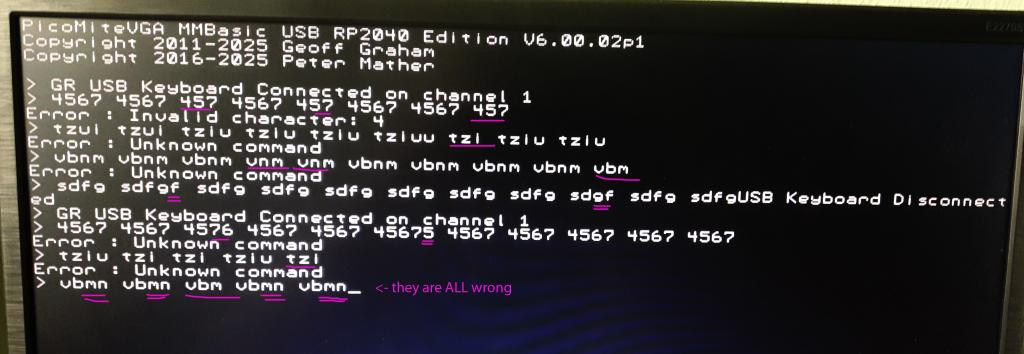

Same problem, but to be sure I generated the MD5 checksum, so that you can compare the version:
Md5 Checksum online tool: https://emn178.github.io/online-tools/md5_checksum.html
It gives me "3971224a263653cd6881573a34df4d7a" for your file.
Here sadly the same problems, new image:

Posted: 02:56pm 07 Jul 2025
Ok done.
With a single finger I wasn't able to produce any false chars or missing or swapped chars. Then I tried to write in my maximum speed in german and english (a bit slower), here I can't replicate any of the mentioned "problems". It only appears if there is rollover involved. And this (rollover?) problem with the group of "VBNM" starts really quickly, I must not type fast that the problem occurs. But what (for me counts) I wasn't able to re-create any of the mentioned problems with normal writing.
Before your fixes, I wasn't able to write the word "save" for example. Now with an english text and some keywords I tested, the problem isn't re-producable under normal circumstances. So for me, as said a few post ago, absolutly usable now. Although the problems persist under the mentioned circumstances, I think we have to live with that - which is fine because:
only a few people have those problems
and as it is now with the fixes, it is even for me highly unlikely that I run into problems again.
So I think further fixes will be just for sports (is it even called this way in english?)
Edited 2025-07-08 01:00 by Amnesie

Tested all keyboards again, only when "typing" really fast (with rollover on the groups of four) I still get the described things like:
VBNM:  vbmn vbm vbm etc..
4567:  4576 457 etc..
But as mentioned, I don't see a chance for normal (or even fastest) writing that those problems will ever come up. I wrote some english keywords and also some english text and german text as fast as I could; no problems.
To summarize: Problems with certain (!) keyboards will persist, but fixed to a level, I don't see any chance to be problematic in real life.
So thank you for fixing it to this point, so that this usb-firmware is usable for those who got those problems. I can imagine it was really hard, specially because not everyone can replicate it.

N-Key Rollover no
Anti-Ghosting no
Cherry G84-4100   (I have three of them)
N-Key Rollover no
Anti-Ghosting no
And my cheap black USB only keyboard definitely hasn't these specification either.
So for all my tests it is maybe from interest, I can now say I have not a single keyboard with N-Key Rollover or Anti-Ghosting.
Greetings
Daniel
Edited 2025-07-09 00:50 by Amnesie
