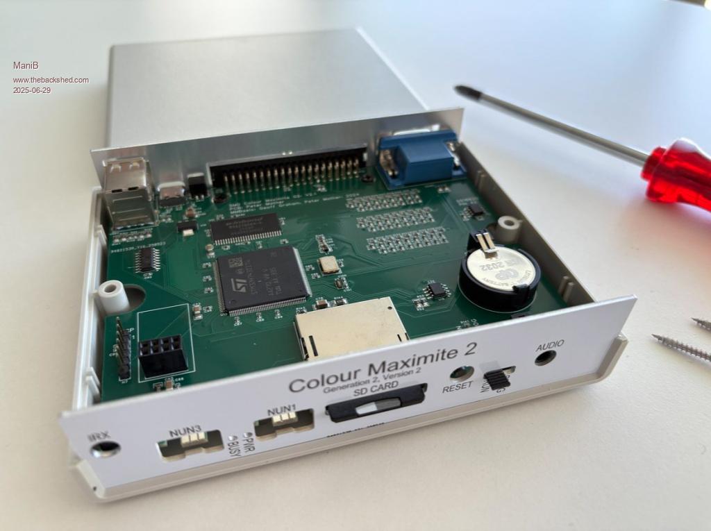

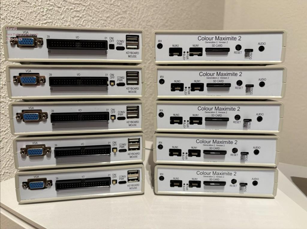

PS: just assembled and shipped ten of the CMM2 G2 V2:

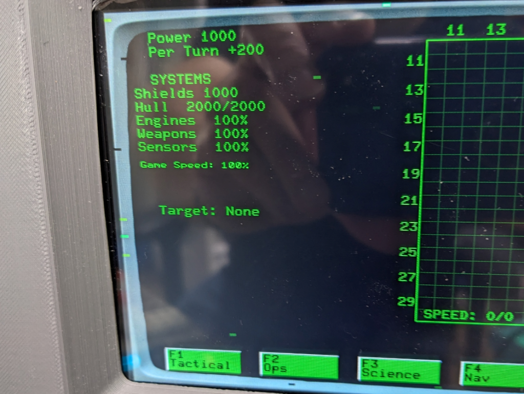

Sorry Peter, but although the keyboard is working again, I'm getting weird artifacts when I try to access the graphics memory.

This is the minimal code needed to check for artifacts
'MODE 1,16 ' 800x600
PAGE WRITE 1
LOAD JPG "img\crt3.jpg"
PAGE DISPLAY 1
DO:LOOP
Where crt.jpg is this file:
